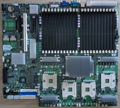

I saw this weird and interesting board on eBay for 120€ and just had to get it.
I have a thing for obscure old hardware - as most of you people here probably do, too. 😀
1.19 MiB
1391 views
Supermicro X7QC3 top view
Isn't this a beauty? This board can take four Xeon X7460 CPU's (the first 6-core CPU's Intel made).
It can also take up to 192GB of DDR2 FBDIMMs and thanks to the one PCIe 16x port (running at 8x) it might even run a modern GPU, like an RTX3060, for example.
First of all: This will be an ongoing build thread. I have no prior experience with socket 604 and if you continue to read this, it will be very obvious why.
I already made quite a few mistakes (all non-fatal, though). At the moment, I'm not able to fully run this board in a stable manner.
Maybe you can help me out with some of my struggles. 😊

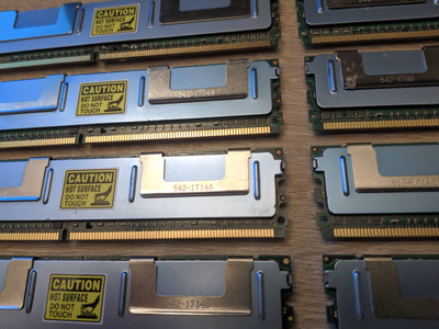

Memory
Getting the memory for this board is not a problem at all. 8GB DDR2 FBDIMMS are extremely cheap. You can get a 64GB kit for a few bucks on eBay and since there are only a handful of manufacturers that made these, it will always be good-quality RAM.
1008 KiB
1391 views
8GB DDR2 FBDIMMs

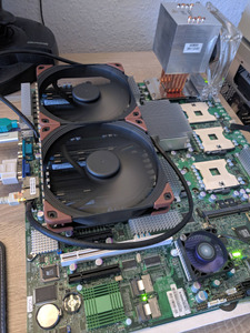

Cooling it down is a whole other thing, though. These sticks get very hot. I had the board running for two minutes with two big 80mm fans on top of the sticks and I still burned my finger when touching one of them (guess I should've read the stickers).
Skorbin already warned me about this:
Skorbin wrote on 2023-06-22, 10:44:
I rather expect the system to get noisy, because DDR2 FBDIMM tends to get rather hot and needs a lot of cooling.
This is a problem I need to solve and I'm not sure how at the moment. I need fans with high throughput to adequately cool these sticks down, but I can't just use Dynatron server fans because these are way too loud and my neighbors will probably kill me if I tried that. If you have any suggestion for high-throughput fans that aren't too loud, I'm very happy to hear them!

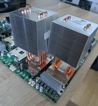

CPU coolers

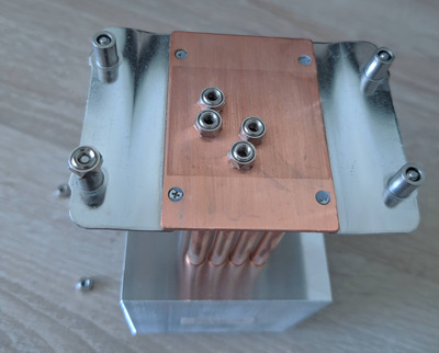

Getting CPU coolers is another very big problem. Socket 604 coolers are intended to be screwed onto the chassis. I don't have a chassis for this board, though. It's way too big to even fit into my biggest E-ATX case and I'm already a bit of a hoarder, so getting a chassis is out of the question. Supermicro also made the weird decision to not use standard Socket 604 through holes. They made the holes much wider and sold individual backplanes for the regular standoffs (their part number is "BKT-0021L").
As an interim solution I got Fujitsu Primergy TX200 coolers. They are easily available. Primergy S2 coolers are Socket 604, Primergy S3 coolers are Socket 771 (but can be used in a "normal" 604 board by filing down the posts by a few milimeters). I was able to screw one of them onto the little sheet metal bracket on the underside of the board with some nuts. Notice the capacitors on the edge of the cooler? I had to file the cooler down a bit so it wouldn't make contact with it.

That's when I made a few mistakes:

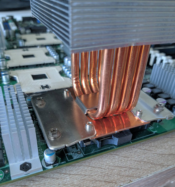

This ghetto-solution works, but it clamps the cooler down on the CPU with way too much force. I need to get these BKT-0021L brackets somewhere to do this properly or find another solution.
Also: The Primergy coolers are a bit too wide. So now I need to find at least two other small-sized coolers because I can't fit the Primergys right next to each other:

All of these parts are pretty expensive. I found some shops for the brackets with ~60$ each. On top of that, I need to get small-sized socket 604 coolers which aren't that readily available in Europe, so I might have to pay the actual price + shipping from the US + tax. I'm sure I'll eventually solve this problem, but it will take some time.

I have a dual 771-based Supermicro board with the same type of RAM and encountered the same problem with heat. For what it's worth about the only ("retail") solution I've seen (but haven't tried myself yet) that I just found recently was a dual 60mm RAM cooler that attaches itself to the RAM socket clips. It's marketed under the brand name "Alseye" and seems to be pretty readily available. Later on I found someone who ended up flipping the placement of the fans on that cooler so that the fans would be closer to the RAM, which seemed to improve the RAM cooling, so that might be something to consider if you end up trying this kind of solution (along with using better 60mm fans than what the cooler probably comes with).

- I never had to deal with them on my 4Ps, but FBDIMM are just hot sods - seems mainly about direction and volume of (again) airflow set against acceptable dBs - some trial and error incoming

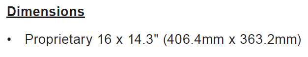

I think the form factor is completely custom. Supermicro made their own version of the WTX standard (SWTX) but this board is even bigger than that.
SWTX goes up to 457 × 330 mm. This board is 406 x 363 mm.
The board's manual even states the form factor is "Proprietary".

Didn't realize how hot the FBDIMM can go. Good thing I didn't have any that needs FBDIMMs. I reused heat spreaders from these to other registered dimms as this was cheaper and easier to get.

Reply 13 of 16, by schmatzler
Little bit of an update:
The overheating memory problem has been solved now.
I got myself two "Noctua NF-A14 industrialPPC-2000 PWM" fans.
They are both 140mm and push a ton of air, while not being too noisy:
1.22 MiB
1034 views
The memory can now be touched without burning my finger, so that's a success!
With that problem out of my way, I can finally test some software. First, I've updated to the latest beta BIOS (the files are dated 2016, but it's actually from 2012).
I couldn't believe my ears: The memory fans are running faster on that BIOS! It seems like they run at ~80% by default.
On the latest beta BIOS they make them rev up to 100% as soon as the boot screen appears. That means I can run the Noctua's at 80% and still be able to cool down the memory properly, wish I had known that before...

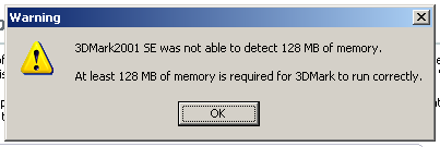

3DMark 2001 is not very happy, but I suspect that's either due too the massive amount of RAM in the system or the fact that it's running Windows Server 2003.

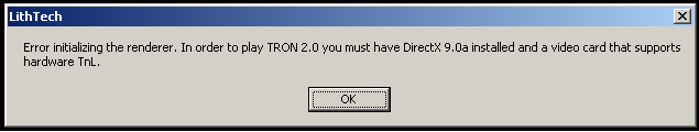

Since I cannot run 3DMark 2001 and its System Info to check if the ATI chip can handle TnL, I opted to install the game "TRON 2.0" - because I remembered it needs Hardware TnL and performs a check for it on launch:
2.5 KiB
1013 views
There you have it, the ATI ES1000 is indeed a Radeon 7000/VE equivalent without TnL.
I get that error too on some systems ... Don't remember which, but it usually runs anyways ...

I never experienced games/apps that required hardware TnL.
I suspected that this existed because late Kyro II drivers allow the user to lie and fake the presence of hardware TnL.
I really don't know why some games required that. Because a powerful CPU can replace hardware TnL.
I've actually tested HL2 with a Radeon VE and it's very playable... With a decent CPU (Athlon64 3200+)
