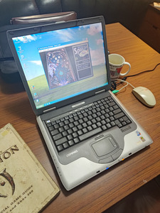

This is my Compaq Presario 2100 laptop. It holds extreme sentimental value to me, as it was the first laptop our family ever had. I've got many fond memories of gaming on it from a young age.

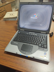

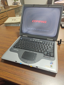

Unfortunately, as you can see from the images, the display has seen better days.

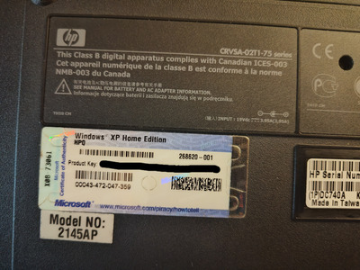

I'm keen to replace the display. I'm pretty sure I found the right one, but I thought I'd post here before I buy, just to be safe.
Does this seem right?

Reply 1 of 2, by andrea
I'm pretty sure it's just a standard 15" XGA LVDS 20 pin panel.
Disassemble the lid and see what is the panel model. In my experience if the signaling is the same (e.g. LVDS, eDP ecc..) and the pinout matches it will work 99.9 of the time.
You should be able to find a used panel or a complete scrap laptop (I'm thinking of those awful awful Acers with a desktop P4/Celeron and a SiS chipset for example) with a compatible screen for very cheap, much less than the new screen in the link you posted.
