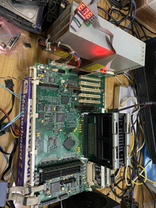

Hi,
I recently acquire the HP Kayak visualize x550 (which i believe that it is Kayak XW badgered)
The machine is able to power up, the little LCD panel show the smiley but there nothing else.

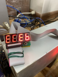

Then i removed all the card, put in a POST card, the post card show some activity then the post is stopped at code E7, there are also some faint (very faint) beep noise from the speaker. Sometime, the LCD screen show BIOS error, most of the time, it happy.
When i checked with the HP document, E7 is the part when bootblock tried to jump start the BIOS.
Thinking that the BIOS may having problem, i tried to flip the sw10 (BIOS recovery) to ON then reboot, the post code now jump to EC and stop.
No matter what ram i put in, it always stop at EC (SW10 on) or E7 (SW10 off).
So what should i checked next?
Now i'm thinking of remove the two bios chip and manually flash the bios onto them. But that is for the future.
The board come with one P3-Xeon 550 processor installed, one termination card on second slot, 2 VRM installed in VRM slot 1 and 2.
mainboard out of the case, with E7 from post card.
when i flip the SW10 to ON.
1.09 MiB
281 views
Reply 1 of 3, by shamino
Do you have a multimeter? Try measuring voltages on the power connector. Perhaps one of the voltage rails is going bad. Bad power could cause erratic/unstable behavior that keeps it from booting.
What exact CPU do you have? I'm a little foggy on Xeons, but I think there are some versions (cache size and voltage spec) that won't work in this board, or at least aren't officially supported.
Does the display thing tell you the BIOS version? It might need an update for the 550.. although if your system was called an "X550" it implies maybe that CPU was original to it.

Reply 2 of 3, by nhattu1986
Hi,
about the voltage, i did a quick check on 5v and 12v rails when the system is powered on and it show up ok, the values is within spec.
about the CPU, it is a SL3AJ 550/100/512 which i believe that it been there from the beginning.
about the bios version, i kind of forgot 😜

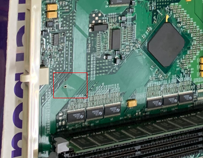

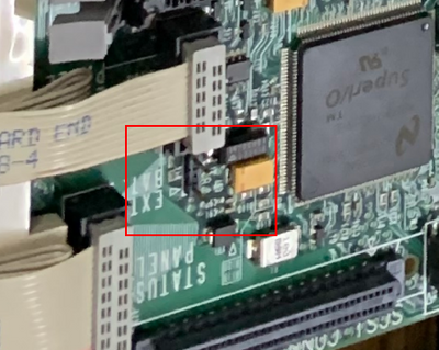

about the internal "battery", it in the following location:
949.56 KiB
250 views
battery
i is not really a battery, but it is super capacitor. I did removed mine.
if you want to use battery pack, there are external battery header at the top of the board, near the scsi connector.

Thanks for the description of how to remove the board, and the info on the battery/capacitor.
Mine stopped retaining settings back like ~20 years ago, maybe 1yr after I had bought the machine on eBay. At the time I then went to a local shop and bought an external battery for it that plugs into those pins.
You know... I wonder if my "bad battery" discovery happened after I stored the computer for a while, when of course it would have drained since it's a cap. Maybe it's actually good. I should look into that next time I have it hooked up.
I've used the SL3AJ in mine and it worked, so that's probably not an issue. BIOS on mine is something.something.05 (the BIOS versions just change that last number, 05 was the last). I don't know what would happen with an older BIOS, but based on the name of your system that's probably the CPU it came with.
If you backprobe into the connector you might be able to also check 3.3V, and keep in mind there are some standby rails also in addition to the primary ones.
I guess another possibility could be the removable VRMs. It's probably difficult to probe those though. They used to be common and cheap on eBay but that might not be the case anymore.
If you probe one of those tantalum caps near the CPU slots, you might find CPU voltage there. If you're worried about shorting anything put tape around the probe. Negative can just go on the PSU case.
Trouble is, the slots have independent power supplies (separate VRMs) so you might have to probe a cap that's near the active CPU, and that looks like it would be difficult.
I don't remember what the spec voltage is for these CPU modules. If you can, also try to watch it while the system is trying to boot and see if it sags and looks unstable.
I don't know if this board will boot without anything on the battery circuit. Some motherboards have issues with that but I don't know for this one.
I'm looking at the dip switch settings in your picture, and I'm wondering what SW9 is. Could that be a bus divider setting for the PCI clock? Have you tried it both ways?
