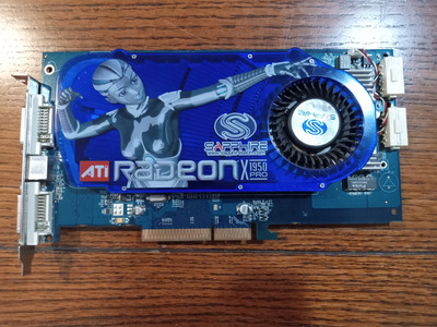

This is my system that I use for playing Windows XP era games, and a lot of GOG games. I built the machine in the early 2000s but I have upgraded things here and there.
Gigabyte GA-7VT600 KT600 motherboard
AMD Athlon XP 3200+

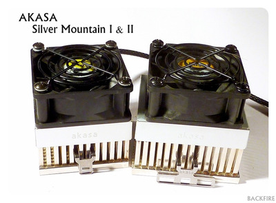

Akasa Silver Mountain 2 cpu cooler
3GB OCZ Platinum DDR400 2-2-2
Sapphire ATI Radeon X1950 Pro 512MB AGP
SB Audigy

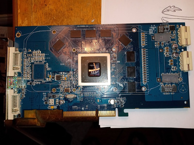

A couple more photos

It actually runs pretty cool with the Silver Mountain 2 cooler. Yeah it performs very well with just about anything I throw at it. I love the performance. I also think it's pretty cool that the graphics card is longer than the motherboard 😆

Do I have to do anything to enable this in WinXP or does it do it by default? Even under load, the Silver Mountain 2 keeps things very cool. I had a smaller copper skive cooler on it a while back and it would get toasty but not anymore.
