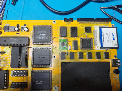

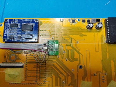

Reply 235 of 343, by n0p
Found small boards, called "SOIC to DIP adapter" here.
Redone DMA hack, and finally put Waveshare Zero Keyboard Adapter 😀 to a ribbon cable. 5V, Ground and Int lines are now more sturdy AWG30 wire.
Still waiting for kbd chip and V2 Book to arrive.
    245.86 KiB
    1035 views
    Kbd adapter
    193.34 KiB
    1035 views
    Kbd adapter
    238.52 KiB
    1035 views
    Kbd adapter
    298.31 KiB
    1035 views
    DMA hack

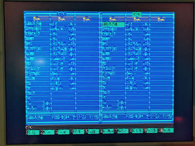

Reply 236 of 343, by n0p
And a question.
Any ideas what problem on ISA bus could lead to this problem? (see photo, EGA on ISA extender)
EGA card works perfect on Pentium, on Book8088 it gives memory error (beeps) and shows that kind of picture.
EGA BIOS makes three-pass REP STOSW with different pattern fill or video RAM and one SCASW (w/o any rep prefix, most probably a bug, but it catches the error anyway) and beeps if RAM not OK. So on Book8088 it's definetely some video memory access error. I've removed CGA BIOS and RAM chips just to make sure, but that didn't make things better.

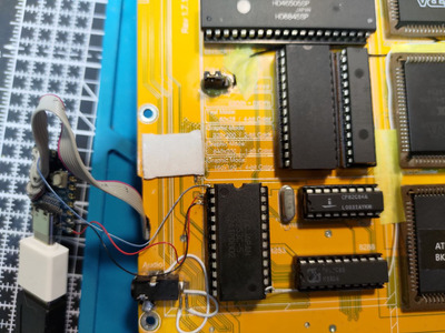

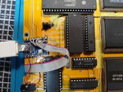

Reply 239 of 343, by n0p
USB wired keyboard is possible, but it ain't an easy task.
I've posted on VCFED and maybe forgot to post here initial release:
Video:
https://www.youtube.com/watch?v=jP_Zx4weHFM
Source code for Pico:
https://github.com/jinshin/BookKbd/tree/stable
Traces are very small and i managed to kill original keyboard IC on Book, awaiting new one.
So the project is not complete, idea is to use Pico as a medium controller, which would process external kbd and onboard IC.
As Pico lines are 3.3V, IC supply needs to be 3.3V. I plan to use 3.3V from Pico in next try and use resistor block to limit current to it from Pico lines. IC Iworks with that voltage (but i killed it on some point connecting it's output to Pico and don't so far get how) and more, XT-IO CPLD chip is fine with 3.3V signals.
