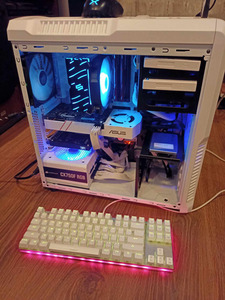

This is my first Windows XP project - "Retrozaur" aka "Retrosaurus".
Purpose of this project: Fastest AGP Gaming Computer in the entire world. I will use best hardware components to reach my goal . I started to buy pieces of the hardware long time age, now its time to build real machine. 
Components in use:

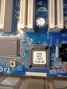

Motherboard: ASRock AM2NF3-VSTA Bios : P3.30-15B; Brand new – shop sleeper, price: 239PLN/60USD. Fastest stock processor for AGP(Phenom 2 x4 980BE), DDR2 1066MHz, SATA+EIDE+FDD;

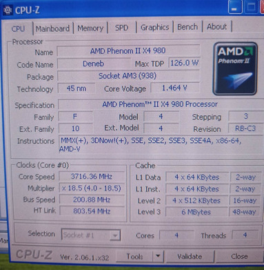

CPU: AMD Phenom II X4 980 BE 140Pln; Fastest stock processor for AGP platform. Unfortunately my piece of 980BE bought from Allegro refuse to do any overclock. Any attempt for overclock cause freezes or restart of the system.

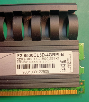

RAM: 2x 2GB G.Skill DDR2 F2-8500CL5D-4GBPI-B 105PLN/26USD; 1066MHz without any problems.
HDD: SATA Crucial M4 SSD 512GB 220PLN/55USD;

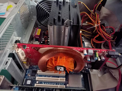

GPU: PowerColor ATI Radeon HD 3850 512MB GDDR3 AGP 255PLN/64USD; Great card, super overclocking.
CASE: BMW PC CASE 😀 Limited Edition PC Case 115PLN/29USD;

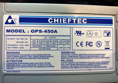

PSU: Chief GPS-450A 49Pln; Max Watts reading from the socket < 250W so 450W is more then enough 69PLN/17USD

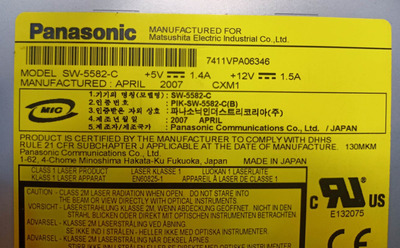

Blu Ray: Panasonic SW-5582-C 149PLN/37USD;
    468.84 KiB
    1170 views
    CHIEFTEC Chief GPS-450A
    323.24 KiB
    1170 views
    336.63 KiB
    1170 views
    412.12 KiB
    1170 views
    Panasonic SW-5582-C

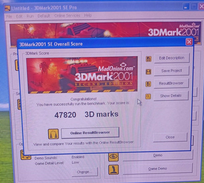

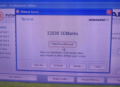

I pieced together a similiar system last year (same motherboard, CPU, and GPU). A great XP machine for sure!

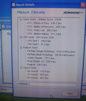

I'd be interested to see what scores you get in 3DMark03. Here's what I got:
"Result": {
"24 sounds": "119.254699707 FPS",
"3DMark Score": "31621.000000000 3DMarks",
"60 sounds": "108.487274170 FPS",
"CPU Score": "2383.000000000 CPUMarks",
"CPU Test 1": "244.023529053 FPS",
"CPU Test 2": "45.874103546 FPS",
"Fill Rate (Multi-Texturing)": "10237.456054688 texels/s",
"Fill Rate (Single-Texturing)": "4929.051269531 texels/s",
"GT1 - Wings of Fury": "635.858825684 FPS",
"GT2 - Battle of Proxycon": "250.094467163 FPS",
"GT3 - Troll's Lair": "202.557464600 FPS",
"GT4 - Mother Nature": "211.567306519 FPS",
"No sounds": "132.721725464 FPS",
"Pixel Shader 2.0": "236.046707153 FPS",
"Ragtroll": "173.403503418 FPS",
"Vertex Shader": "153.899398804 FPS"
"Settings": {
"Anti-Aliasing": "None",
"Checksums Valid": "No",
"Comment": null,
"Display Changed": "No",
"Fixed Framerate": "Off",
"Force PS 1.1 in GT2 & GT3": "No",
"Height": "768",
"Invalid Score": "No",
"Max Anisotropy": "4",
"Max CPU Frequency": "3718 MHz",
"Max GPU Engine Frequency": "0 MHz",
"Max GPU Memory Frequency": "0 MHz",
"Max Run Length Deviation": "0 %",
"Min CPU Frequency": "3718 MHz",
"Min GPU Engine Frequency": "0 MHz",
"Min GPU Memory Frequency": "0 MHz",
"Min Run Length Deviation": "0 %",
"NullPS": "No",
"Post-Processing": "No",
"Registration Key": "N4LWE-T6HUX-8U4JB-28YLV",
"Repeat Tests": "Off",
"Texture Filtering": "Optimal",
"Vertex Shaders": "Optimal",
"Width": "1024"
"Version": "3.6.0"

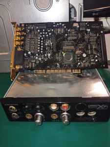

I found some sound cards in my chest:
-Sound Blaster (CA-20K1-PAG) X-Fi SB0460+SB0250+remote control. I used this card in Win7, remote control didnt work but I am not sure was it hardware fault or drivers.

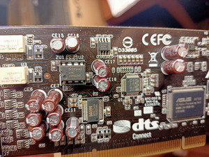

-ASUS XONAR DS/A with replaced amp for : LME 49860NA. I used this card in the past, best for music listening 😀 I remember that amp replacement give big boost in sound quality.
I have more models but looks like those 2 are my best for PCI slot.
    280.62 KiB
    1158 views
    390.26 KiB
    1158 views
    ASUS XONAR DS/A with amp: LME 49860NA
Reply 11 of 17, by shevalier
SmartSailorTV wrote on 2023-08-18, 21:18:
X-Fi SB0460
this, Asus also HBA.
At the same time, I would not recommend using 5.25 bay.
This one has mediocre performance, it is more for appearance.

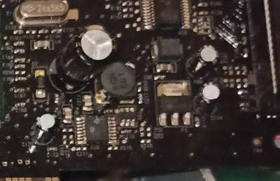

PS. If X-fi is buggy, I would recommend replacing this largest capacitor here. This is the genetic disease of all PCI X-fi`s.
On some polymer, 3-6.3V with a capacity of 560-1000 uF.
    30.45 KiB
    1112 views
Aopen MX3S, PIII-S Tualatin 1133, Radeon 9800Pro@XT BIOS, Diamond monster sound MX300
JetWay K8T8AS, Athlon DH-E6 3000+, Radeon HD2600Pro AGP, Audigy 2 Value
Reply 12 of 17, by acl
shevalier wrote on 2023-08-19, 06:15:
Does it affects most of these X-Fi cards ? What's the problem ?
I have the same card, also with the fron panel, and i must admit I only installed it for the look and it's not even connected.
Edit : there is normally a dissipator on the X-Fi chip iirc
Reply 13 of 17, by shevalier
acl wrote on 2023-08-19, 07:23:
Its affect ALL pci x-fi.
Usually the sound starts to break, then the card generally ceases to be initialized.
This is the main power capacitor DSP X-FI.
No capacitor - no X-Fi
The front panel has a headphone amplifier.
Very shitty quality.
And it is connected to a separate DAC, also of very mediocre quality.
Сreative`s came the idea what else to plug into the front panel - and let's plug in a headphone amplifier.
But what would be cheap.
Well, that's how it happened.

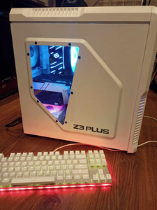

After many boot failures, unexpected errors/power off`s, freezing screens and not so many blue screens, I was able to force GART to work with Catalyst 8.12 drivers. I had to install GART driver (downloaded from ASRock page) in Safe Mode and after this activity, Catalyst driver recognized GART as installed. It didnt work if I installed GART in normal WinXP mode .
Everything except FDD is in place. BMW PC Case looks really awesome, those blinking leading lights 😀

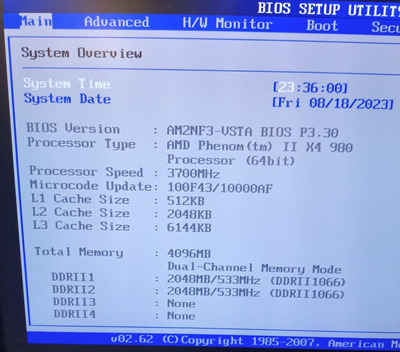

Brief summary of "Retrozaur" project:
1. Motherboard ASRock AM2NF3-VSTA Bios : P3.30-15B is compatible with Phenom II X4 980 out of the box. Same with RAM 2x G.Skill DDR2 F2-8500CL5D-4GBPI-B.
At this moment ASRock AM2NF3-VSTA is really problematic. Every attempt to restart PC (in windows or by restart button) results same as shout down system, computer refuse to boot, freezes and shouting down during recognizing of installed hardware. WinXP "Power Off" option itself works without any problem. I hope it is possible to fix it in bios settings.
When computer is started by button, it is happening(freezing and shout down) from time to time.
2. "Retrozaur" power usage from electrical socket (peak) -no more then 250W ("peak"observed during blue screen)
    181.47 KiB
    928 views
    Power peak consumption
    252.66 KiB
    928 views
    System Overview
    114.07 KiB
    972 views
    BMW Car signal lights ON
    122.15 KiB
    972 views
    BMW FWD LIGHTS

Hi,
This is my score in 3DMark03, all clocks in stock settings.
upd. Score in 3DMark01SE attached.
    388.96 KiB
    928 views
    3DMark01 47820pts
    505.71 KiB
    965 views
    GPU-z Stock Settings
    627.74 KiB
    965 views
    CPU Stock Settings
    662.43 KiB
    965 views
    3DMark03v1 32036pts
    511.4 KiB
    965 views
    3DMark03
