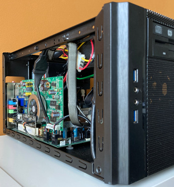

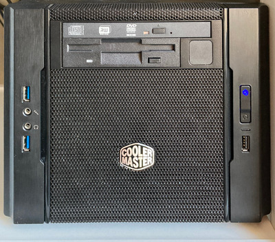

First post, by Bruno128
FlexATX PC in small modern case running WinMe. Targeted games: 1997 – 2001. Build is retired in 2023.
Highlight parts:
  • Intel Pentium 4 Northwood 2.6
  • FreeTech P8F155GE
  • 512MB OCZ Performance DDR PC3500
  • MSI MS-8889, Medion OEM GeForce 4Ti4200-8x 128MB 222MHz DDR
  • Sweex SC012, CMI8738/PCI-6ch-LX HRTF 3D Audio
Misc parts:
  • Optiarc Slim DL DVD-RW AD-7540A
  • TW-813 JAE-50 IDE adaptor (part. nr. 1M-010-53020-A)
  • NEC FD1231
  • Chenbro SK41202
  • Corsair SF450 Gold + ATX bracket
  • Cooler Master Elite 130
  • 20GB Phison mSATA SSD + mSATA adaptor + VLI SATA to IDE adaptor
