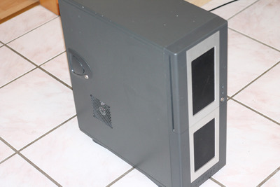

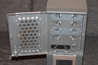

The Case
This case is an Acquisiton I made about... a Decade ago.
It is a Chieftec BX-01 (If I am not mistaken, I'm not a 100% shure on this),
all Grey with Aluminium Inlays and Black Grilles.
This thing weights a TON... well actually 13.5kgs... without the PSU.
Yes, it is used, but I love this Thing.
One of the best, if not THE best Case I ever owned.
841.67 KiB
666 views
779.31 KiB
666 views
1.14 MiB
666 views
775.17 KiB
666 views
Fans are NOS Compuman Fans, 4x 80mm and 2x92mm, some are missing the Fan grilles, but these have gotten pretty expensive....
Also I am still missing a grey 3.5" Drviebay cover/ a 3.5" grey Floppy, again these are either expensive or unobtainium.
The Front I/O Panel features IEE1394, 2x USB and AC97 Audio headers;
(I might design an upgrade Board featuring USB 3.0, HDA and maybe USB-C?... I might... not shure about it though...)

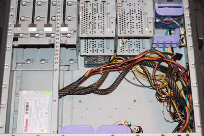

The PSU
Power Supply wise, I went with Enermax.
It is a FMA II-Series , EG465AX-VE(G) Supply, 465W power delivery Capacity.
Not shure if it will stay, although it is a pretty beefy and stable PSU.
I got it used, unfortunately it still has a pretty strong nicotine Smell.
871.61 KiB
657 views
I think this is a solid base for the System so far.

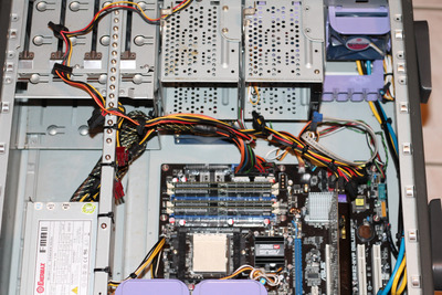

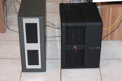

I did some parts hunting for the case to get all the missing parts, like Drivebay Covers, Slot covers, Drive Screws, Fans, etc.
On a side note, this case is the Successor to the venerable and legendary Chieftec CS 601 Midi Tower.
The first Picture is a Comparison of the Chieftec Midi Tower and my Daily/CAD Rig in a Corsair Carbide 540 Air Case...

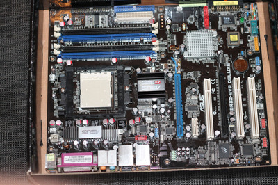

The Motherboard
This is the first time using an ATi Chipset based Board in any of my Builds.
The Board is an ASUS A8R32-MVP Deluxe. nIt is RD580 based and so far.... I am not convinced of this Choice.
The Board was sold to me with an A64 3200+ (E6) which works fine, until you try to setup anything CPU-related by hand. Either the board doesn't POST at all, hangs while detecting SATA devices, or crashes when loading an OS.
Same thing with all other CPUs so far (Opteron 180, X2 3800+, X2 4800+). BIOS is the latest one (0701).
If the Board is running though, it is pretty stable and fast, tests with Debian 12, W7 x64, XP x64 do yield pretty good results. Debian complains about some ACPI Bug with the ALI 1575, which I couldn't workaround so far, but the system runs fine.
1.12 MiB
587 views
1.66 MiB
587 views
1.48 MiB
587 views
I don't think it is a RAM issue either, because the aforementioned errors are reproducable with different RAMs or RAM-configurations.
Speaking of....

Reply 4 of 6, by acl
Hi
Regarding RAM and stability, I had a long lasting stability problem when using 4 sticks in dual channel on my s939 system.
Any 4xDDR kit I tested reported memtest errors and caused random system freezes (sometimes after 10minutes, sometimes after 1h. Really random)
The long story is here : My first retro build : 2005's finest (almost)
But to summarize, i changed everything without any improvement. Using 2 sticks instead of 4 fixed the issue.
Reply 5 of 6, by shevalier
acl wrote on 2023-10-15, 19:15:
The manual directly states that 2 single-sided sticks - 400 MHz, double + single = 333, two dual = 266.
Or use register memory.
PS. With a particularly successful instance of CPU and memory, it can work at full speed, but this is not guaranteed.

Nviduum wrote on 2023-10-03, 21:15:
The Motherboard This is the first time using an ATi Chipset based Board in any of my Builds. […]
The Motherboard
Speaking of....
The RAM
I acquired some RAM over the years, including some 550MHz OCZ ones (which will absolutely not work on the Board).
The RAM I chose are 4x Samsung 2Gbytes PC2700R ECC RAMs. These do work pretty reliable up to 450MHz @ 2.7V. The Board does support 8Gbytes of RAM so I will roll with it.
A future upgrade would be some PC3200R ECC Sticks, but we'll see.
An interesting board and nice find. First ATI 's CF-capable northbridge + ULI southbridge.
ATI was stuck with it's abysmal SBx00 after Nvidia bought ULI. They were pretty crappy southbridges until about SB7xx.
What technique did you use to delid the CPU?
(I guess new delidding tools for AM4 could also be used. )
About RAM issues , it could be many things: CPU mem. controller revision, motherboard/BIOS, RAM itself and voltages.
