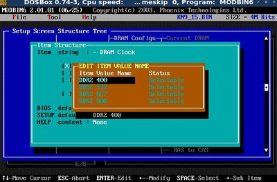

So far, so good... found working MODBIN6 version. Here's the result from latest non-beta BIOS ver.15:
57.52 KiB
941 views
no-dividers-in-the-ddr2-menu
There're frequencies for DDR2 instead of the divisisors ratios. Sh*t!

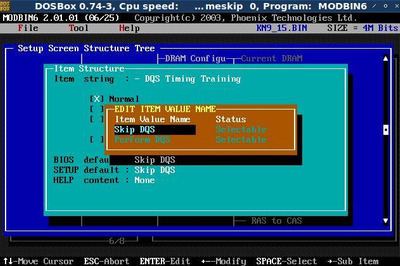

Bonus stupid question: What is this "DQS Timing Training" in the same DDR2 settings menu?
66.03 KiB
941 views
what-the-hell-is-this?

Reply 29 of 57, by shevalier
analog_programmer wrote on 2023-10-04, 16:43:
So what...?
Divide by 200. I.e. 2 or 2.66 or 3.33 or 4.
FSB = 200 and RAM = 4*200=800 or =3.33*200=667
FSB = 240 and RAM = 4*240=960 or = 3.33*240=799
Auto-adjustment of sub-timings (which are not set in the BIOS) every time you turn on.
This often causes problems, so when overclocking it is better to turn off.

I'll rename this stupid fixed DDR2 frequency fields to FSB x 2/1, FSB x 8/3, FSB x 10/3 and FSB x 4/1, so it will be easier to calculate the resulting DDR2 frequency by just knowing selected FSB frequency. It's a shame that this is an oveclocker's mobo and some options in the BIOS are so stupidly labeled. Also there are so many locked BIOS menu items. I whish I had this MODBIN tool back in the days when I bought this mobo brand new...

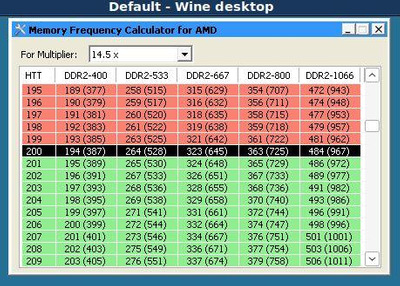

stef80 wrote on 2023-10-05, 04:46:
Don't mod it. It's a nice board for what it is.
HTT/DDR2 calculator for AM2: http://downloads.pcrpg.org/comp/automemcalc.zip
Thank you for this convenient little tool. At first I thought "WTF HTT (hypertransport bus) of 150 to 350 MHz?", but then realized it is wrong and this is actually FSB. Remembered - RAM frequency depends on hypertransport's frequency not directly on CPU's, so it's not so easy to adjust stable overclock just by FSB and CPU multi.
54.94 KiB
860 views
HTT is not FSB
As for the NF4 Ultra -> SLI mod it's reversible, so maybe one day I'll try it just for benchmarking purposes.
P.S. About the mentioned problem for the non-integer CPU multiplier values: I think it's chipset related.
