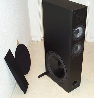

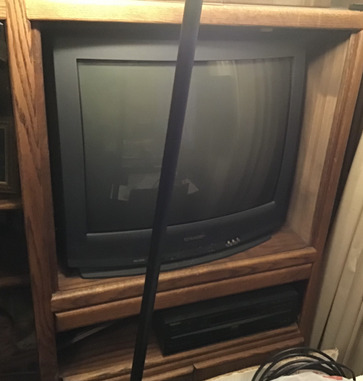

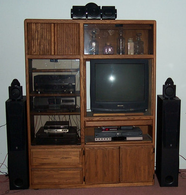

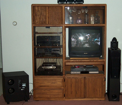

I think I still have a couple VHS tape players in my garage. I have a VHS tape Dupe copier too.
I Still have my Oak entertainment center from 1980’s that I purchased at Costco. It still has my 32-inch CRT TV and 5-Disk DVD player in it.
It use to have my VHS player too and my 1980’s Home theater Receiver and Stereo, CD player, EQ, Phonograph, etc.

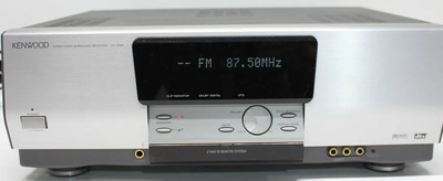

My old Home theater sound system was a Kenwood AVR that I still have in my garage along with some others.
I have a 5.1 THX surround sound system with Messina triangle surrounds and Yamaha towers for fronts speakers and a 12-inch subwoofer.
Some times I would switch the speakers out for the Wharfedale home theater speakers which had a nice warm natural balanced sound.
I sold most of the electronics back in 2008 but some are still in my garage in boxes.
Here are some photos of my 1980’s home theater system vs. Modern day home theater.
