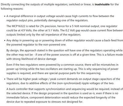

Reply 8 of 26, by kingcake
Sphere478 wrote on 2023-10-28, 18:30:
Na, that’s not how dc works. You can parallel multiple DC sources of identical voltage.
Sometimes this can cause more (or less) line noise. But I don’t expect you will have problems relating to this. The condition of your mobo caps would be where I looked if you did.
Differrences in MOSFET Rds will cause one MOSFET to do most of the work. You can't just slap them in parallel. You need matched pairs, use balancing resistors, etc.

Reply 10 of 26, by rasz_pl
kingcake wrote on 2023-10-28, 20:00:
Connecting another buck converter in parallel works just fine, mosfets are deep down the chain in front of coil/diode/filtering network. One caveat is Voltage level, but it works out in the end.
Julian Ilett Parallel Boost Converters https://www.youtube.com/watch?v=bIN-WEKI8BE

Reply 16 of 26, by kingcake
rasz_pl wrote on 2023-10-28, 21:21:
Are you really posting a retired sign repairmen that teaches people how to build lithium death traps on youtube as a primary source? Did you even watch the video? He has to fiddle and fiddle to tune it. The SECOND the load changes you will have to start over.
303.48 KiB
830 views
There's a reason motherboard manufacturers don't put a bunch of cheap, dumb buck converters in parallel. Because you can't. Period. One converter will always be sourcing and one will always be sinking.
They use synchronous buck converters with multiple phases.
Here's a brief summary paper from TI about this: https://www.ti.com/lit/an/slyt748/slyt748.pdf
But if you want to keep believing randos on Youtube, be my guest.

Reply 19 of 26, by rasz_pl
kingcake wrote on 2023-10-29, 01:09:
fiddling is for demonstration purposes, they are self balancing. If there is offset one will take the brunt of the load until it cant keep up and sag to the level of the other. https://www.digikey.com/en/articles/paralleli … er-output-power
If you worry this much add blocking Schottky diodes.
