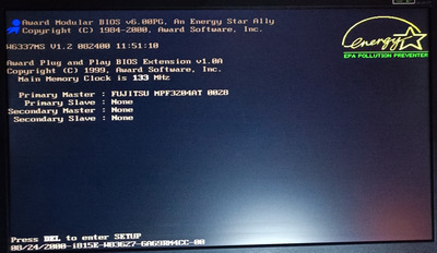

im new to this forum and created an account just for this issue that has been plaguing me for the past days now. After hours and hours of trying to figure out what im missing or doing wrong, I realized that I need help with this. Please bare with me as I am a noob when it comes to working on old PC parts and old operating systems. I can build a new computer just fine, but quickly realized that finding drivers and getting everything to work properly with old hardware is a nightmare.
I recently purchased a generic (Sintechi?) SD to IDE adapter (https://www.ebay.co.uk/itm/193578823084?hash= … P0AAOSwmlZfEUUF) and a 32GB SD card to go with it, in order to use with my retro builds that i've recently started working on. After watching several videos on YouTube and reading through forums about these adapters I decided to give it a go, since it seemed pretty straight forward getting them to work.
I have two old PCs I dug out from the closet that were my childhood PCs. One "AST Advantage! 623E" (similair model to the one found here: Manual/Info for an AST Advantage! 624) with a Pentium 100mhz + 32mb RAM and a noname mid-tower build with a P3 800mhz and I think a Geforce 4 series card in it.
First i tried getting the old AST computer to run with the SD to IDE adapter, but it didn't even detect the adapter at boot-up. I tried formating and re-formating the SD card in different ways, everything from FAT16 to FAT32, 2GB up to 32GB. I noticed that the BIOS didn't detect any sectors or such, but then again, the computer didn't even detect the adapter at all on boot-up.
I gave up on getting it working and just installed everything on my old HDD instead that came with the PC.
Then i tried again on the P3 800Mhz PC, but with the exact same problem. The PC doesn't even recognize that the adapter is connected. All drives at boot-up just says "None".
The adapter LEDs turns on fine and is visibly powered, but I really don't know what im doing wrong since every single video i've seen on this adapter just makes it seem like it's working straight out of the box.
Philscomputerlab, LGR and many more smaller channels just plug it in and their computers recognize the adapter on boot-up.

It could be that the adapter is trying to request LBA mode or ECHS mode that your computer's BIOS can't handle.
Try configuring your BIOS to one of the default drive types to see if it works. If that works, you could look into adding an option rom like XTIDE Universal BIOS or a disk overlay like EZ Drive 9.09 that would correctly autodetect the drive at boot time.

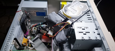

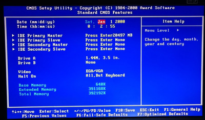

Ok, so I connected the HDD so I could at least boot up the computer, connected the SD to IDE adapter in the second IDE-slot on the motherboard and the computer still doesn't recognize it (no surprise there).
Can I use my primary HDD to install the drive overlay on that or does it need to be installed on the actual SD-card that the computer can't read? Or can I run the software from a floppy at startup? Also, what does this "EZ drive 9.09" software actually do?
Where in the bios can i configure the drive to be 40mb if it can't even find the adapter? In the menu where you change the sectors etc on a drive?
Sorry for the fumbling, but this is clearly beyond my knowledge.

Usually you can manually enter the drive parameters if the auto detect doesn't work. I've been soending time with older bios lately, but I noticed that there are triangle to the left of the drive table. Does that mean those sections can be expanded to see additional options?
Is the Sinitechi on its own cable? Some people have reported problems getting a Sinitechi device to autodetect the slave/master situation.
