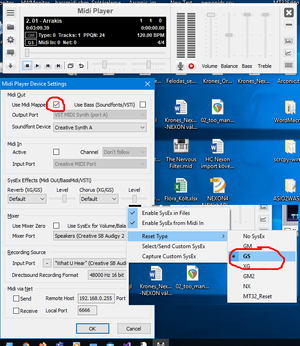

@zaphod77:
You can try this:
It keeps VSTi plugins open and you do not need software Midi cables for simple playback of XG/GS Midi files:
I think Phil's video explains best how to configure it:
https://www.youtube.com/watch?v=vSk9S1bkRS8&t=502s
For XG use S-YXG50.
For GS use SC-VA.
For MT-32 use Munt or the built in Munt VSTi plugin.
For OPL3 you can use the built in OPL3 GM VSTi or ADLplug VSTi.
Website, Facebook, Youtube
VST Midi Driver Midi Mapper

I promise it's the last time I react but it's hard to understand why you have not just tried it instead of listing features seemingly not available (but in reality they are).
E.g the exe size is less than 400k, loads immediately, does not load its own synth unless you explicitly ask it to do it. And finally the manual reset button is right there on the right side of the player...

That is the 64-bit version... The 32-bit version is 444, 416 bytes. But even the 64-bit version still fits on 1.44 floppy 😀. Moreover it's portable so requires no installation (just copy anywhere and it runs) as well as it's a native exe so it has no dependencies on various frameworks (.NET) or even MS VC++ runtime libraries.
You will not find a "potato" Midi player that has "non-potato" features such as manual Reset with selectable SysEx types and so on...
