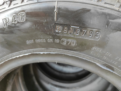

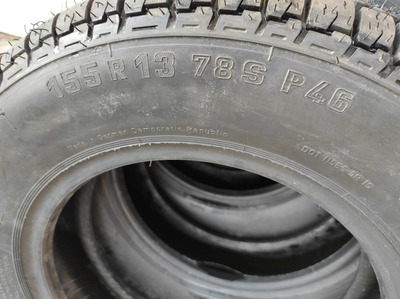

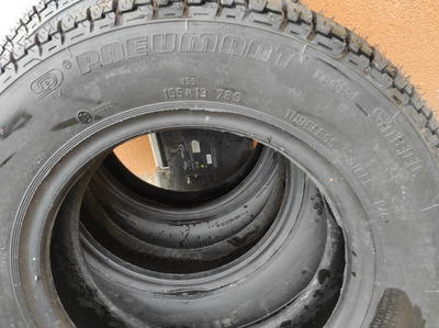

Found these unused set of tires in my late grandpa's garage but I'm having trouble determining the date of manufacture.
Could you help me? Are these winter or summer tires? I don't know anything about them.

Reply 1 of 4, by technokater
Looking at the DOT number: week 37 of 1990
I just noticed, "Made in German Democratic Republic", so back when Germany was split.

Reply 2 of 4, by Grzyb
"370" seems to mean 37th week of 1990.
Anyway, genuine tyres from German Democratic Republic - perfect match for vintage cars like Trabant or Wartburg.

Reply 3 of 4, by Lutsoad
Thank you guys, I knew I can always count on this forum no matter the subject.
I'll put them up on Marketplace and hope they will find a new home but I doubt a 30+ year old set is safe to use even if it's never been used before.
They are in pristine condition though, no cracks or blisters.
Reply 4 of 4, by PD2JK
I wouldn't drive on the Autobahn with them. But they're perfect for oldtimer enthousiasts.
