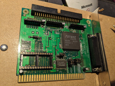

So I have an XT without usable fixed storage media and I have a Future Domain TMX-850MEX 8b ISA SCSI controller and some very old SCSI drives. Sounds like a match made in heaven. Just one challenge: unlike the TMX-850M, which always seems to come with a bootROM, the 850MEX does not - despite silkscreen & pads for a 28p E(E)PROM, two SMD LS-logic chips and and a couple of other components, I've not been able to find any pictures online of this exact board populated, and its layout and possibly components differ from the 850M.
Two challenges:
1) not sure which parts are actually needed for booting - some are clearly related to termination power, not ROM, but even around the ROM I'm not sure - on the 850M cards that definitely can boot, only an LS244WM is populated, the LS00 pad is as empty as on my board - and there indeed exists a version of the 850M with only no LS00 pads at all.
2) the silkscreen doesn't give values for the passive components.
So:
- anyone know why the 850M doesn't always need that LS00 (NAND gates)/what they would be for?
- anyone have a booting TMC-850MEX who can share component values or really good pics?
In particular I'm interested in:
C6 (SMD cap)
L1 (current regulator diode?)
C2 (SMD cap)
R2 (SMD resistor)
C7 (small through-hole electrolytic)
- I suspect the latter two are only needed for termination power, together with a 1.8A self-resetting fuse

My MEX PCB is identical to the first eBay link you gave - https://i.ebayimg.com/images/g/kqYAAOSwHxJkdkuP/s-l1600.jpg -, just minus the EPROM, the LS244 and C2, so that's pretty much what I need then - U1 (the LS00), L1, R2, C1, C6 and C7 are also unpopulated there. That means C2 is the only unknown. I can't make much out from the pic. What I can see on my board is that its left pad connects to pins 27 and 28 on the EPROM (resp Program and Vcc accourding to this datasheet) and its right pad goes to ground - so sounds like a filter cap. The same datasheet states:
It is recommended that a 1μF ceramic
capacitor be used on every device between VCC
and VSS.
So I suspect a 1uF SMD cap is the way to go. Sound likely?

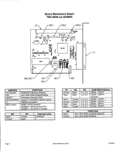

added: found this in the archives, you probably already have it.... (was a .bmp converted to .jpg):
    495.11 KiB
    697 views

added: found this manual for a NEC scsi cdrom, the included controller (XT003FD) is a TMC-850:
http://archive.retro.co.za/archive/computers/ … I-Interface.pdf
Nice extensive documentation - apart from the BIOS, this is 100% relevant to the TMC-850MEX card, in particular the address and IRQ settings.

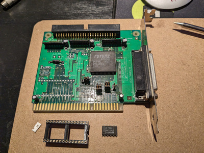

Update:
Two packages arrived so got down to some soldering.
Before:
1.28 MiB
444 views
After:
1.17 MiB
444 views
Unfortunately I have managed to misplaced the termination power fuse, so this is just the LS244, filter cap and socket.
I've confirmed card is still working correctly, now to find those EPROMs...

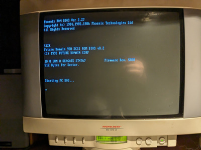

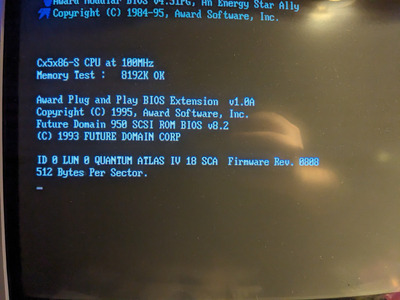

...and found them -Atmel 28C64B EEPROMs that are still fairly readily available. Flashed the image and this was the result:
853.42 KiB
411 views
Success, it pops up at boot and detects drives. Even VERY big drives like this Quantum Atlas IV 18GB monster. In fdisk it only shows 1292MB so something not right. Why am I testing with such a huge drive? My ex-Sun ST31200WC (1.2GB and noise to rival a 747 going to full thrust) doesn't spin up. Not sure if it's controller, drive or SCA-50p adapter related, but one way or another not working. And my 640MB drive is holding up the monitors on my son's desk (er, srsly) and I can't find that old 50MB disk.
So can't test end-to-end yet, but looks like the operation has been completely successful 😀
Will try to extract usable drive from that desk and confirm 100% asap.
