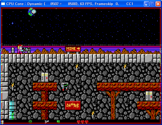

Reply 5 of 100, by HunterZ
I have a comment (not a complaint by any means!) based on that screenshot - it seems to be doing weird things with the color blending:
- blending of white and red makes green (look at the $ on the lower-left and the stone along the left and right edges of the screen)
- blending of brown (red+green) and red makes purple/magenta (look at the wood platforms on the right side)
- blending of hi-intensity red with red makes a weird pastel yellow (look at the heart highlights at the bottom middle)
I'm guessing it's doing some quick-'n-dirty math on the color values or something.
Reply 7 of 100, by Kippesoep
Looks like its overflowing istead of saturating when adding the colours. Vasyl's earlier screenshots didn't show this bug. Could be related to desktop bitdepth (perhaps it's a bug only in 16bit mode, not in 32bit mode).

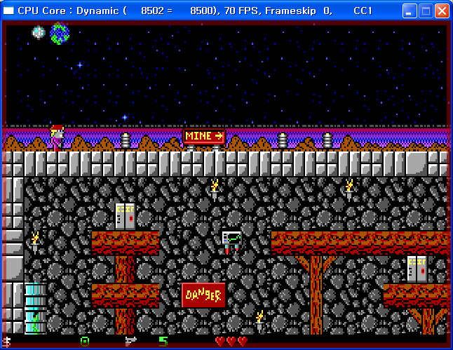

Reply 8 of 100, by ykhwong
I'm usually using 32bit depth colors.
I set overscanstrength=30, then the border seems to be correct.
(default value was 2)

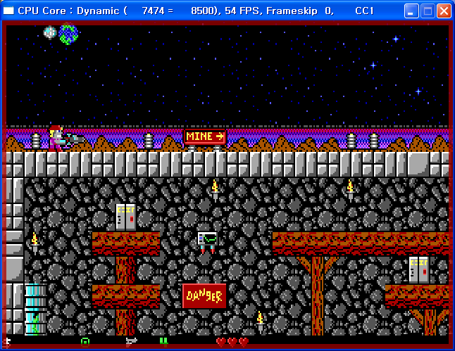

Please see this screenshot.

Reply 9 of 100, by Kippesoep
That cannot possibly be right. Looking at Vasyl's patch, he uses interp_w2 to blend the two pixels. There, a blend weight of 30 means that the border should have an opacity of 30 parts in 31 (just under 97%). It would look nearly solid red, which it doesn't in your screenshot.
According to Vasyl's patch, the accepted values are 1..10 anyway. Setting it to 30 will actually be the same as setting it to 1 (resulting in 50% blending -- which is what it looks like in the screenshot).
Without seeing the code, I can't really tell what's going on, but there has to be a bug somewhere. The problem HunterZ first mentioned is definitely an error in blending, as there is no way in which proper blending could make dark red (at 67%) and white (at 33%) result in light green.

Reply 13 of 100, by Kippesoep
Weird. It looks fine, but the value is strange. At overscanstrength=3, the white of the dollarsign should have its blue/green levels reduced by a factor of 4. Since the white isn't pure (0xFF in each channel), but slightly darker (0xFC), I'd expect 0x3F for blue/green. Instead, they're 0x38 (reduction by 4.5).
Not really a problem and perhaps caused by something else (maybe something as simple as gamma correction in your PNG), but it bugs me that I can't explain it.
Still, this version does show a proper red everywhere. If it works at factor 2 as well, I think the bug is probably just in my mind. Just ignore me 😢
Reply 15 of 100, by vasyl
I did not measure exact color values, relied on interp_w2 implementation itself. The first (broken) screenshot is really odd. It seems that blending almost worked but there was color overflow from one component to another, almost like blending was used on some packed color format without unpacking first. That suggests bug in interp_w2 but the CVS version looks rock solid to me. Bug like that would also cause color artefacts in complex scalers.
