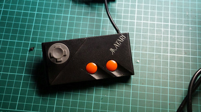

There was a gamepad for the Atari 2600 Jr. that looks like the Sega Master System pad.
It may works on the Atari ST, too.
The pad is quite common here in Europe.
That thumb joystick can be removed, so you have an ordinary d-pad.

That's designed as an Atari 7800 controller, but they may have also distributed it with 2600Jr consoles. It's much more common in Europe than in the US. The US mostly got the "ProLine" 2 button joystick which sucked. That 2 button gamepad controller came later and replaced it.
A minor advantage of the 7800 controller is that a 2600 will see both buttons. Atari wired it so that both buttons activate the 2600 button signal, but also send a separate signal that a 7800 can use to distinguish the buttons from each other. With a Sega controller, only 1 of the buttons will be seen by an Atari.
