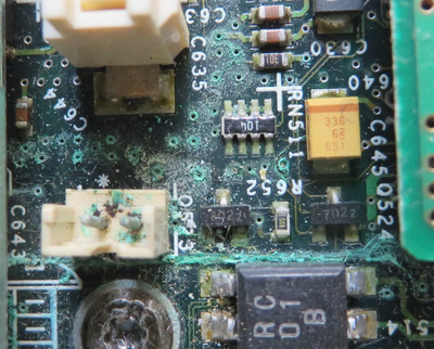

It does not look like there's damage, boards seem clean and the hibernation/CMOS battery does not shows sign of having leaked. Actually there is some damage, see here: Re: Help / Advice repairing or diagnosing Compaq Armada 7710MT

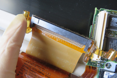

The display ribbon cable seems fine too.

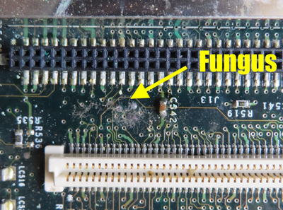

There's a bit of fungus here and there, but I've seen much worse on fully working computers.

Edit: update because there's some battery leak damage

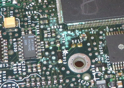

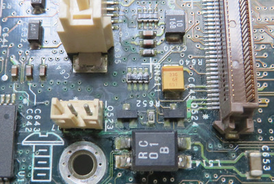

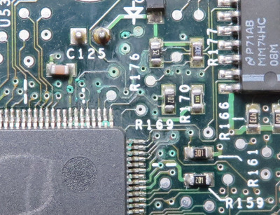

Reply 1 of 4, by anton23
Actually, it turns out there was some leak damage, around the battery connector.
I tried cleaning with isopropyl alcohol, but it still shows the problem.
I tried checking the traces and many are good, I couldn't check them all because I'm not sure the isopropyl is cleaning all the rust and some pads seem covered with it.
I'm also concerned about some white stuff around the pinss of one big chip on the bottom. Cleaning removed some of the white stuff, but not all, some seem under the chip.
I was wondering if there are more in depth cleaning methods to remove the leak residues, maybe some vinegar ?
Reply 3 of 4, by 3lectr1c
Ouch, that’s rough. That sort of damage is really hard to repair if it gets into the vias. I don’t have advice to offer, just wishing you luck.

Reply 4 of 4, by ediflorianUS
Did you clean it? Did contact cleaner or/& WD did the job? can you see if you pull KB cable+ screen cable if all 3 lights are up? can you use a V-meter on Ohm settings on a cap and see if it*s shorted?
*That C542 Cap in 2nd image seems changed already.... that big chip next to the corrosion may be gone... is not looking 2 good.
