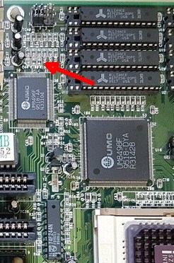

Evreka! It's working!
If you look at the later revision of this board, there are more empty spots for jumper resistors (R100 and R101):
43.75 KiB
492 views
I installed two 0 Ohm (0805) resistors in those spots and after that (along with the other resistors you specified), I had KBDO/KBCO/KBDI/KBCI all connected to the inverter pins on the UMC chip.
I proceeded to turn the system on but was still getting a "22 1C" post code like before, so I swapped the VIA VT82C42N with a Mega-HP 'F'. Now, the system still wouldn't post, but the post code changed to "38 3A" (Shadow system BIOS ROM/Autosize cache). This post code has nothing to do with the KBC so I decided to swap the phoenix BIOS for the Award BIOS. Now, the system posted, so feeling encouraged, I tried to open the BIOS file in MODBIN to enable PS/2 support. Unfortunately, MODBIN complained of a checksum file error and refused to open it. Looking at the BIOS string (2C4X6H01), I found a correlation with the PCChips M912 (the boards are almost identical). This BIOS opened and I was able to enable PS/2 with ease.
Next, feeling encouraged, I proceeded to install the VT82C42N back into the board without the interposer, and the keyboard worked perfectly fine (so KBC compatibility seems to be BIOS-related rather than something else). Then I installed the interposer and booted the system from a floppy. CTMOUSE installed right away in PS/2 mode. I fired up EDIT.COM which is what I use to test the mouse functionality, and I sat there dumbfounded as the keyboard stopped responding (and not to mention, the mouse wasn't working either).
Walking around befuddled by my misfortune, it dawned upon me that I was a big dummy and I forgot to connected the IRQ jumper wire I had already soldered and had sitting there disconnected from the interposer. I connected it, booted the system, and everything worked.
Thanks for your encouragement and support Paar. Great work, cheers!
