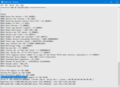

Contrary to NTFS in case of FAT/FAT32 partition alignment is not enough to get optimal speed.
In case of NTFS metadata is part of the file system (MFT) but in case of FAT/FAT32 the metadata is before the file system and the size of metadata is not fixed but depends on the partition and cluster size.
In order to get optimal speed you need to get First FAT table, Second FAT table, Root Directory and most importantly the First file data (cluster 0) to begin at aligned LBA addresses.
On Windows you can use RMPrepUSB to check if this is the case.

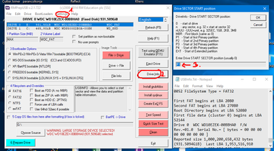

Yes, I think you are right (according to my test the starting addresses do not change at all: additional entries are simply added to normal data region). But as you can see from the data of my drive starting from the 1st data sector all addresses are separated by cluster sized units (in my case cluster size is 64 blocks = 32k). Since the root directory table is already part of the data region it can only grow granularly (by cluster sized units). So if the 1st data address is properly 4K aligned then proper alignment cannot change even if some regions have to grow provided your cluster size is at least 4K aligned (always guaranteed in case of realistically sized FAT32 volumes).
So overall I think in case of FAT-32 you only have to make sure that FAT tables and starting of data area (includes root directory entries) are properly aligned at creation time. Partition alignment alone does not make a difference. Data clusters have to be aligned instead. For proper FAT-32 4k alignment this means that the 1st data cluster has to be at an LBA address that is divisible (at least) by 8. Later even if root directory entries grow the alignment cannot be ruined (confirmed by test)

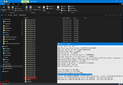

@Edit:
Your suggested test is done (only 21790 directories are made since it takes a long time to make more and I think making more is not too realistic):
132.9 KiB
470 views
As you can see the alignment and even the starting addresses have not changed.

Which tool are you using that can provide the data region start? I won't bother to align anything on FAT machines, but I'd like to play with it
Reply 14 of 15, by Falcosoft
konc wrote on 2024-02-26, 12:21:
Falcosoft wrote on 2024-02-26, 11:22:
Very good point, it seems that you are correct again and initially aligning the data region is enough.
AFAIR, at that time for the mentioned drive I used mkfs in Linux, but nowadyas under Windows (mainly for flash media) I always use RMPrepUSB. RMPrepUSB also has ALLDRIVES mode in settings so you can use it for normal HDD/SSD:
