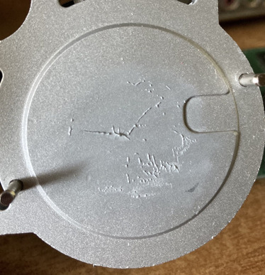

Does the GPU core temp move when you stress the card? Does it get to 80?
There's no way it's hot if the heatsink isn't hot. Paste looks fine
OK, so I applied some new thermal paste and now it shows 66 degrees on the desktop. Apparently, the contact between the heatsink and the chip got better? 🤨
I played Doom 3 on the highest settings for 10 minutes and the maximum temperature was 72 degrees. The heatsink's still as cold as ice.
upd Attached a photo

To me it still looks like that heatsink is still barely contacting any parts of that chip. Again lots of thermal paste is WAY BETTER than air.
Bluetooth heatsinks aren't a thing. 🤣
elszgensa wrote on 2024-03-04, 19:20:
I recommend giving thermal pads a try, at least temporarily. They perform a bit worse than well applied paste - but they are much easier to use, and also take care of height differences between chips, or off kilter heatsinks to a degree.
This is a good idea, a heatsink with a thermal pad is significantly better than a heatsink with paste that doesn't actually touch the chip.

To me it looks like it barely touches, go with the pad idea and if that solves it then you can try some copper shimming for a more effective solution or an aftermarket cooler.

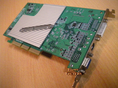

The heatsink is mounted differently.

No screws to tighten, no springs or other tensors that I can see. If that card came from the factory with pads (I have no idea about this model, can't say either way), which are thicker than a layer of paste, you now have less mounting pressure, which certainly doesn't help.
edit: Apparently there's supposed to be a pad on the back too to make good use of that side's sink, don't forget that one. Oh and further down I saw paste in all but one contact point on the sinks so that's alright.

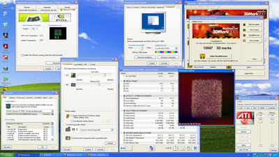

Well, I think something is wrong with that graphics card, because mine does not heat up at all with the default frequencies, between 43 and 52 degrees, and it is even quite good at overclocking, +100 MHz core and +66 MHz ram, I think it can go even higher, but I only did it to check if it would overheat, but the maximum core temperature was 70 after passing 3DMARk2001 as you can see in the screenshot.

Interesting, 52 is on desktop? I mentioned earlier that when I was playing Doom 3 on high settings, temperature got up to 72 degrees max, pretty close. Is your heatsink hot to touch?
