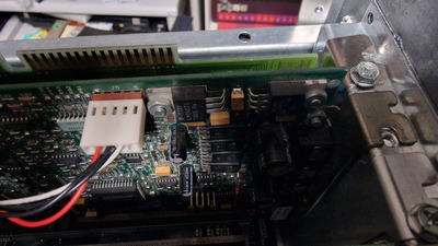

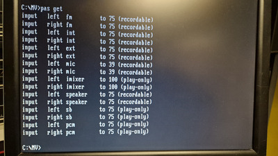

hi, i own this card but the internal cdrom audio loop through does not work. there is no sound at the output.
i think the wiring is correct. Cdrom output ok. i have tried on J5 and J13. Any idea ?
