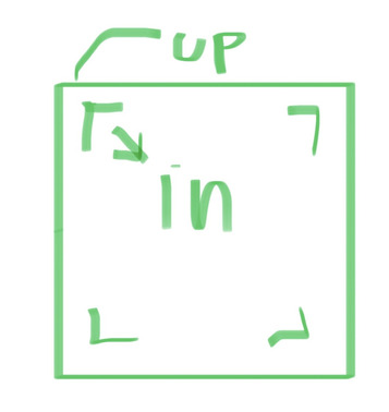

Like the post title says, how would you go about removing this CPU from it's socket? Is there a special tool? I feel uneasy about using a PLCC removal tool because it would only lift two corners at a time, not all four.

Reply 2 of 15, by Sphere478
The clips that you need to press are the crescents on the corners at the top. You push them in toward center slightly and lift flange that surrounds the CPU those little tabs stay with the motherboard and the entire flange around the perimeter lifts off of the rest of it.

Reply 13 of 15, by Sphere478
The L shaped tabs get pushed inward while lifting the outer flange
