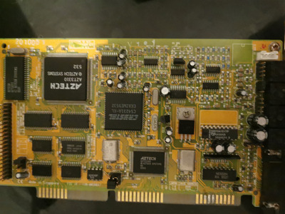

Reply 14 of 23, by Babasha
Yeap! OPTi are interesting cards)
    321.49 KiB
    549 views
    328.29 KiB
    549 views
Reply 15 of 23, by stanwebber
Babasha wrote on 2024-03-18, 07:11:
i own the 82c924/930 versions of the 2nd card with a ymf262. i think the 82c925 is opti fm like the 82c931 which also has a version with the admos qs700 wavetable (some have wavetable header populated). i'm not sure if the 82c925/931 are non-pnp.
the 82c930/qs700 card is probably still for sale on ebay NOS for around $30. it does have a quirk where the fm/midi output is quite a bit louder than the sb/wss. also, there are no xp drivers for the card, but you can get the nt drivers working.
edit: i just noticed the first card has a ymf289b. nice! never even seen one of those come up for sale before.
