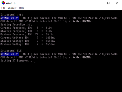

Reply 202 of 320, by SaxxonPike
Thank you so much for this utility!
I just grabbed v1.24 to test with an Athlon XP-M 3000+. I have it installed in a KT133A board, the Soltek SL75-KAV. The processor works great and is stable in this board. Crystal can set the multiplier in Windows without issues all the way up to the processor's reported maximum, 16.5x. The startup multiplier and FSB frequency are configured via jumpers on the motherboard. Voltage is configured via a BIOS setting.
SetMul shows all the current settings correctly. Disabling or enabling the L1 cache with SetMul seems to work fine. However, when I attempt to use SetMul to change the multiplier to anything else, it hangs at "Setting K7 PowerNow..", regardless which drivers or TSRs I boot with.
Here's a captured screen from the machine:
The attachment k7hang.png is no longer available
Anything I should try, or additional info you will need to diagnose this one?
