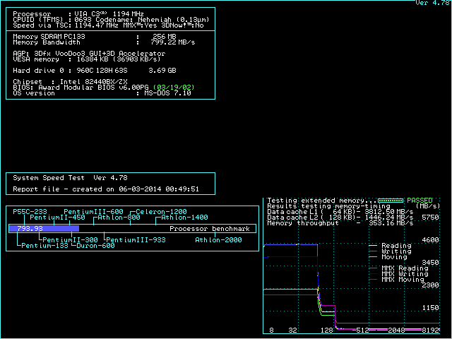

Most of the SetMul functionality is for the VIA C3. But the user base for this series of processors is very small. We had a discussion about it here: Cyrix III (i.e. VIA C3) for vintage gaming?. Not all things there reflect my recent experience with VIA C3. Which goes like this:
The C3 is a further development of the Winchip, with VendorID 'CentaurHauls'. With the right slotket any VIA C3 processor ran on all four of the i440BX based boards that I tried, from Aopen, Gigabyte, Soyo and Shuttle. The right slotket being the 'MS-6905 Master' for any C3, and the 'Upgradeware Slot-T' for any Tualatin socket version: Ezra-T and Nehemiah.
All VIA C3s ignore the normal Intel multiplier jumper signals, but they do support software adjustment. Later C3s have bridges on the CPU package that can be modded to some degree, to change the default multiplier.
The VIA C3 Samuel 1, Samuel 2, Ezra and Ezra-T are quite similar. I could not get their cache and memory throughput up to Intel level. I don't know why that is. This is about the fastest of this first series, on a GA-6BXC board, LFB write combining enabled:
VIA C3 Ezra-T (C5N) at 9.0x133=1200MHz:
-Speedsys=626,28 pts.
-Quake I - 640x480=38,1 FPS.
-PC Player Bench=50,5 FPS.
With certain caches disabled it does make a good 286/386/486/586 emulator. On a BX, We did not have that before.

The next and final C3 version behaves differently, it makes the previous versions seem unfinished. Cache and memory throughput are sufficient now:
VIA C3 Nehemiah (C5XL) at 9.0x133=1200MHz:
-Speedsys=793,93 pts.
-Quake I - 640x480=71,5 FPS.
-PC Player Bench=106,4 FPS.
This version is not as good in 486 emulation though; It does up to a 486DX-40 at most. Still it does better in that regard then the Intel Pentium II/IIIs.

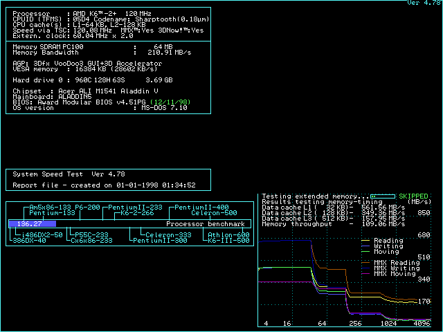

I tested it with my K6-3+ last night. With a 2x multiplier and 66Mhz bus Speedsys rates it as a P133.
I was hoping that disabling the caches too would give me something slower than a 386-40 but interestingly multiplier doesn't seem to make any difference to the Speedsys score with both caches disabled.
Also, I noticed a difference in Speedsys score when disabling both caches through the BIOS as compared to disabling them using SetMul.
L1 & L2 disabled through BIOS = ~10
L1 & L2 disabled through SetMul = ~19
Perhaps the BIOS disables both L2 & L3, whereas SetMul only disables L2?

When you use an AMD K6 with on-Die L2 cache, the motherboard external cache changes from L2 to L3. I found that when I disable the L1 cache, the L2 seems to become non-functional too. Giving me 20,87 points in Speedsys at 2.0x60=120MHz. This is with the L3 cache still working. If the L3 prevents the system from getting slow enough you should try with the external cache disabled in the BIOS. SetMul only toggles CPU on-Die cache. I don't know what the resulting speed will be.
When left without sufficient cache, data must travel to and from RAM all the time: the FSB speed becomes even more important then it already was, while the clock multiplier matters less. Unfortuntely I do not have much success in changing the FSB speed on an ALi Aladdin V board without reboot. The ALi Southbridge is not well supported, while for i440BX boards there are several tools to do just that (SoftFSB, SetFSB, CPUFSB, RayeR's SMB for DOS).
In Speedsys you can see the raised memory speed ranges in the lower right graph. The three different levels indicate that L1+L2+L3 cache is at work there. One can see what size these caches have, even without reading the text in the graph.
The attachment K6-2+_2x60.gif is no longer available
Reply 7 of 340, by bjt
That explains my results. I got a SpeedSys rating of ~10 with all caches disabled, regardless of multiplier. This is roughly equivalent to a 386-40. I'll have to try one of those software FSB programs to see if I can slow things down further (TX chipset).

Just checked the VIA C3 Nehemiah with the SetMul options for Cache and such, and setting FSB speeds from 50 to 133MHz. Lowest SpeedSys score I could get is 3,77 points (~386SX-20), this could be ramped up gradually to 14,46 points (~486DX-40). When enabling all L1 cache again it jumps to 127,30 points at least.
I could also use Throttle to get even lower Speedsys scores on that machine. But that ACPI slowdown method does not always work well with games.
