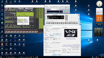

zapbuzz wrote on 2020-12-23, 04:22:
Hi. I have used the 64bit version of the midi player and I like it. I am an old fan of XGEDIT 95 and am waiting for someone to c […]
Hi.
I am an old fan of XGEDIT 95 and am waiting for someone to create a successor inspired by it.
I use windows 10 with VirtualMIDISynth to load my soundfonts one of which is a Yamaha soundfont.
unfortunately xgedit 95 crashes.
t9999clint is right. You can use XGEDIT with Midi Player + S-YXG50 VSTi plugin. You should use LoopMidi or similar virtual Midi cable to attach XGEDIT to Midi Player (That is select the same LoopMidi virtual port as Midi out in XGEDIT as Midi In port in Midi Player)
443.34 KiB
2438 views
You can get the VSTi plugin from here:
https://veg.by/en/projects/syxg50/
And LoopMidi from here:
https://www.tobias-erichsen.de/software/loopmidi.html
And be aware that XG compatible SF2 soundfonts even in theory are not possible. I have written about the reasons many times. Here is one explanation:
https://www.un4seen.com/forum/?topic=19092.ms … 33792#msg133792
