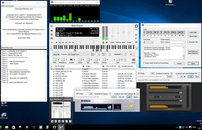

SoundFont Midi Player is a powerful midi player/router and real time midi synth combo, especially useful for Soundblaster (Live, Audigy, X-fi) users
who can load soundfonts automatically and real time. From version 2.0 Bassmidi output mode enables this feature to anyone.
Features:
1. Fully configurable Midi in and out ports.
2. Real time program and bank modification on any midi channel.
3. Real Time effects on any midi channel.
4. Mute and solo on any channels.
5. Variable Tempo and Pitch during playback.
6. Virtual Piano (F1-F8 Function keys for octave change)
7. Chord mode for Virtual Piano and Midi input.
8. Send Sysex for Synth (GM, GS, XG, GM2, NX and custom)
9. Midi send and receive over Net.
10. Karaoke midi files support.
11. Bassmidi output mode.
12. Spectrum Analyzer.
13. Module files (mod,xm,s3m,it) playback support via converting.
14. Record to wave, mp3 (or any acm codecs) capability.
15. Real time soundfont loading from playlist.
16. Scale effect settings (transpose notes to different scales).
17. Supports Cakewalk/Sonar instrument definition (.ins) files.
18. Supports Sysex capturing from Midi input.
19. Supports VST effect/visualization and VSTi instrument plugins.
20. Fully supports Windows 9x, XP, 7, 8, 10 moreover Wine. (But it requires a Pentium class CPU with FPU).
Here in this topic me and James-F are trying to figure out how to build the best all-around midi player that not only useful for soundfont users but anyone.
Especially Roland HW/SC-VA and retro gaming are in the focus nowadays.
Current achievements are better compatibility with SC-55 and SC-VA including the most complete Capital Tone Fallback solution currently available.
Latest version added MT-32 support by integrated Munt VSTi.
Current development version can be downloaded from here (only exe files are included so downloading previous full version is required) :

Reply 13 of 2658, by James-F
I agree about LoopBe, too sensitive, LoopMIDI let the user set its feedback loop time.
But if you already send All Off to all 16 channels why do you multiply it by the number of used tracks? This is completely unnecessary, once for all 16 channels is enough (saying the same as you are).
These 2 actions are not exactly the same. Double clicking involves midi data (file) reloading, but clicking play (in any positions including start) is not, since the file is already loaded.
Ah okay.
It still sends the Patch list twice when I click Play from a Stopped state.
It also sends the All Off list twice when I click Stop from a playing state.
BTW: I want to say that the Master Volume sysex is very useful, thank you for that.
Reply 14 of 2658, by Falcosoft
Hi,
As I have written yes, you are right it is unnecessary. But if you look at type 1 midi file spec, all parts are built on tracks. So my parser parsed the tracks sequentially and recorded the used channels. (You have no information in midi 1 files on track independent used channels). In the new version only note off messages uses this scheme and All Sound Off/All Note Off controller messages are sent once (twice 😀 ) to all 16 channels whether they are used or not. It's still more simple and economical.
I will investigate the duplication cases.
Website, Youtube
VST Midi Driver Midi Mapper
x86 microarchitecture benchmark (MandelX)
Reply 15 of 2658, by James-F
Thanks!
Looking forward for the best Midi Player experience.
If it's not too cumbersome, can you please add a Reset sysex when clicking Stop.
Unless there is a reason not to...
Reply 16 of 2658, by Falcosoft
No problem, reset on stop, got it 😀 It will be the same reset type you set in the right click context menu of Reset button. So 'No Sysex' will not send Sysex, just controller messages.
Website, Youtube
Reply 17 of 2658, by James-F
Exactly, Thank You!
BTW, the file Orc3gm.mid is not 25 minutes long, it plays a long silence in Falcosoft player; It should be 2:20 as reported by other players.
Reply 18 of 2658, by Falcosoft
Well, the length of Orc3gm.mid is debatable 😀. Actually there is a legitimate event at 25.22.76, but of course Midiplayer's calculation method should be corrected by convention.
Website, Youtube
Reply 19 of 2658, by Falcosoft
Just for the fun GNMidi agrees that Orc3gm.mid is 25 minutes long.
BTW I have added Reset on stop and modified length calculation (skips end of track meta events).
http://falcosoft.hu/midiplayer_35_test.zip
Bye
