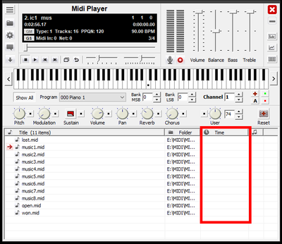

Sorry, I should have been clearer.
The Time table in the Playlist is not recalculated after opening FSMP, maybe it would be a good idea to recalculate them after opening FSMP?

Reply 1162 of 1727, by Falcosoft
James-F wrote on 2021-01-02, 05:47:
Sorry, I should have been clearer. The Time table in the Playlist is not recalculated after opening FSMP, maybe it would be a go […]
Falcosoft wrote on 2021-01-01, 18:43:
James-F wrote on 2021-01-01, 14:49:
I think playlist times need a refresh when opening FSMP.
I do not think so since playlist times are always calculated real time (they are not loaded back from storage).
It is always recalculated after opening by a separate thread. It seems this thread is completely blocked/frozen on your system. I could never meet /reproduce such situation on my systems so far. So it is not a refreshing problem but a more serious issue. It would be good to find out what causes this problem.
Since when have you been experiencing this strange behavior? In version 5.8 more work is added to the thread in order to calculate also default Midi System (right next to time column). As can be seen on your screenshot this info is also missing so it's definitely a problem with this thread. Can you reproduce the issue also with version 5.7? Also what happens if you reset every setting of FSMP to default? Or if you change the files on playlist?
If the problem is caused by one of your 11 Midi files on your current playlist, please attach the files here.
Website, Facebook, Youtube
VST Midi Driver Midi Mapper
Reply 1163 of 1727, by James-F
I've reset to defaults and the Time is fixed now.

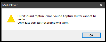

But I have a bigger and probably the most annoying thing I have experienced with FSMP.
How in the world I get rid of this damn thing? I'm trying for an hour now.

Reply 1164 of 1727, by Falcosoft
James-F wrote on 2021-01-02, 10:24:
I've reset to defaults and the Time is fixed now. But I have a bigger and probably the most annoying thing I have experienced wi […]
We have already discussed this one previously 😀
Re: Falcosoft Soundfont Midi Player + Munt VSTi + BassMidi VSTi
The point is:
1. The error message shows because you disabled all recording input sources.
2. You can avoid the error by either enabling a recording source or opening Device Settings dialog and pressing the minus sign next to Recording Source -> Input Port and finally pressing OK.
