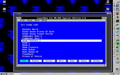

Reply 65 of 100, by theelf
Hi, i love this DOS launcher, *but* I use in my Windows XP laptop, to launch win32 ports of DOS games (prboom, etc)
I will love to do a native console windows port, anyone knows if the source code is public?

dr_st wrote on 2020-10-26, 13:11:
What's the point of a text-based launcher for Windows, when you have a built-in, feature-rich GUI?
That's like asking "What's the point of Dosbox, when you can play Doom Eternal and Horizon Zero Dawn?"
Have you seen his setup? He is blending Windows 95 and 3.11 aesthetics and it looks very clean. I would honestly prefer a DOS interface for my DOS gaming, too.

Sorry, that's a flawed analogy. Your example is about playing different games. Here we are talking about using a text-based launcher to run the same Win32-native applications that you can run using the built-in shortcut (.LNK) feature of Windows. To this I don't see the point, other than, well, aesthetics. And when it comes to aesthetics - to each his own. 😀

My understanding was that theelf's question was not about a DOS interface for DOS games (which I prefer too, although I use a different menu myself), but a DOS-style launcher for Windows games.

Yeah, but again: have you looked at his screenshot? Having a DOS style launcher makes perfect sense in that context and compiling that one to run on Windows XP natively might be a real possibility, so him asking is not unreasonable, I think.
But if that is not possible you can always simply start your dosbox from a shortcut and autoexec the DOS Launcher there.
