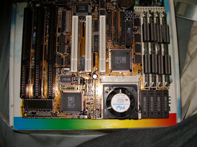

I was bored yesterday and took the time to throw together another socket 3 system with parts that I have purchased in the last month or so. I have tried before with a socket 3 system, but the end product was never stable.
This system is together and it works!! I was grinning ear to ear all of yesterday. I've attached a picture of the motherboard. It was made by a company called lucky star it went out of buisness in the late 90's. I was able to get the board brand new. The chipset is the SIS 496/497.
The cpu is a pentium overdirve 83mhz processor; here are the other specs:

    SIS 496/497 chipset motherboard

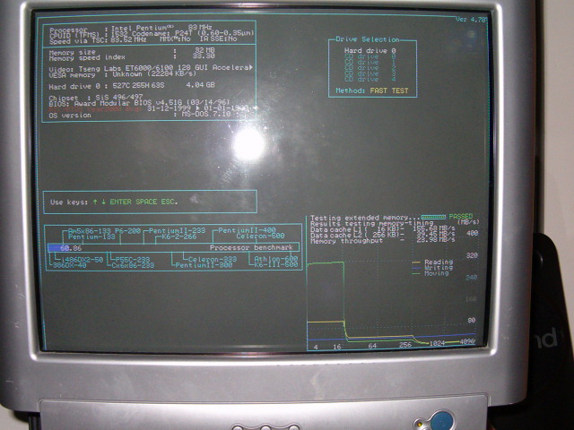

Reply 12 of 39, by 2Mourty
I will do the benchmarks when I get home from work. I'm interested in the results.
I have a mini-tower at case with a turbo button and the display that should show the speed of the processor, I have not figured out how to attach it to the motherboard correctly yet... I'll take a picture of the system and post it.
Reply 13 of 39, by 2Mourty

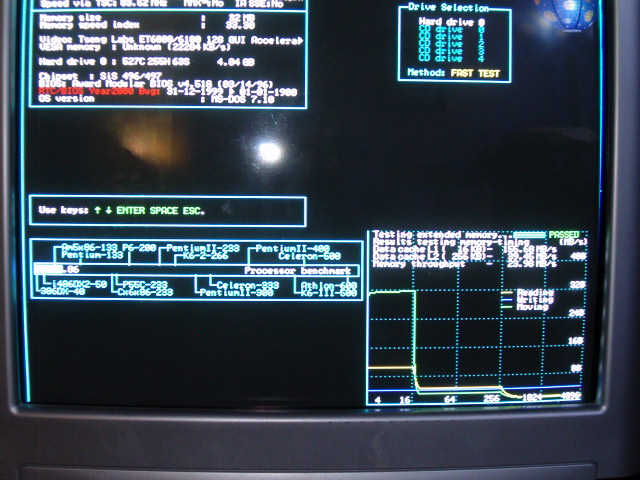

The PCBench had a score of 8.3
I am posting 2 pictures with the results of the speedsys tests. I am posting two because some might have an easier time seeing one or the other. You'll have to let me know if these score are good or pathetic. I ran the test with some fairly aggressive memory timings.
If you have ideas for how I can tweak the bios for better scores let me know. I had fun.

Reply 15 of 39, by 2Mourty
I'm to tired to switch out the edo ram and put in FPM memory to make a comparison tonight. The ram I'm using is some pretty crappy edo I stole from an old fic pa2002 motherboard I fried by accident a while back. I wonder if some good 60n memory would get better scores.
I will get some pictures of the rig another night for you to see =) This test was at a 33 mhz system bus, I wonder what upping the bus to 40 would do for the numbers...
Reply 17 of 39, by Amigaz
The Pentioum Overdrive really shows it's muscles here but it seems like it's severly restricted as usual judging by your pcplayer benchmark result.
Is the cpu's L1 cache set to writeback?

Reply 18 of 39, by 5u3
Whoops, I just realized I uploaded an old version of SpeedSys. 😊
Latest version is 4.78, not 4.70. Get ver. 4.78 here.
