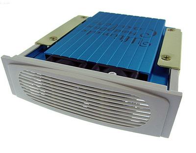

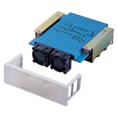

Originally, I had a 2gb IBM SCSI hard drive in this PC. I later added-on a second 4gb IBM hard drive. Around 2002 and after 4+ solid years of heavy use, both of those drives started to fail. I replaced them with the 10,000 RPM 18gb drive you see in the pics. Unfortunately, it too failed quickly and I RMA'd it. Then, that replacement failed too. After the third replacement also failed, I began to suspect that the drives were cooking themselves to death. To cool the drives, I bought one of these and ran it for a few years:
64.39 KiB
676 views
This is a stock photo.
43.15 KiB
676 views

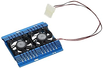

I also attached one of these to the bottom of the drive (which you can't see in my photos):

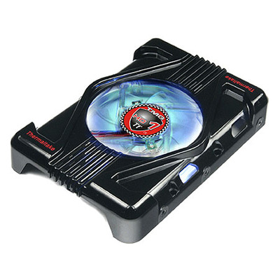

Although the drive did not fail again, I suspected that the massive heatsink on top wasn't making good contact with the top of the hard drive. To test it, I smeared on some TIM, mounted it again, and then removed it. Sure enough, only about 15% of the heatsink was making contact. I then chucked the heatsink cooler, put the 5.25" bay covers back on, and installed this ThermalTake TMG-HD1 which you can see in my pictures:
36.14 KiB
676 views
27.7 KiB
676 views
It's a really good hard drive cooler. I especially like how the fan can be removed and turned over to reverse flow (which I did). Since the fan can be removed, it can also be replaced when it fails. The downside to this cooler is its massive size. With the drive itself, this cooler, and the other cooler on the bottom of the hard drive, the whole setup is consuming two full 5.25" bays. However, I am confident that my 10,000 RPM drive will not fail due to overheating again.

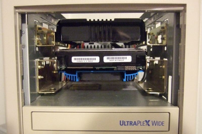

If anybody was wondering how my HDD cooling setup looks from the front, I removed the 5.25" bay covers and snapped a photo:
70.54 KiB
688 views
This is my own photo, that I took myself, of my own computer. I consider it to be Public Domain.

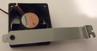

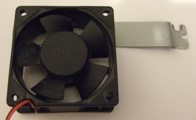

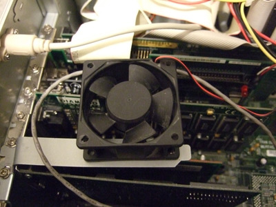

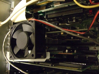

Very clever on the slot cover to hold a fan - is it very stable? Does it add a lot of noise?

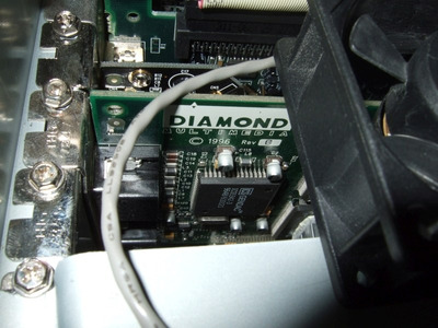

It's very stable, solid, and not very loud either. Here are a few pics of it and how I've got it attached:
49.01 KiB
686 views
58.25 KiB
686 views
81.75 KiB
686 views
As you can see in the last picture, it actually has two screws holding it down. It's really a very solid hack. It doesn't move at all.
The Evercool fan in the front of that case is a real howler. I'd get a quieter fan, but I'm afraid it wouldn't move as much air. Since that is currently the only intake for that system, I can't afford to reduce performance.
