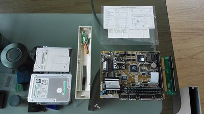

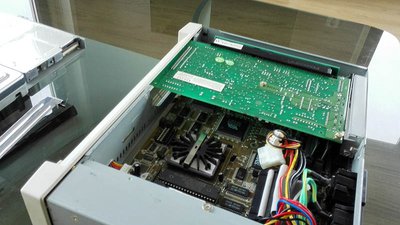

Finally got this nice little unit. 😊
Maybe replace the HD with a CFcard.

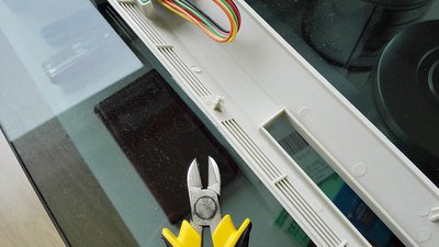

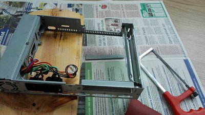

CPU maybe upgrade to DX4 100mhz or even an AM5x86 133mhz, though need to cut a hole in the slideable rack
on the right of floppydrive to make some clearance for the cpu coolblock/fan + drilling holes in the casing above that area.
So far, I have tried many games like transport tycoon deluxe, doom, little big adventure...etc. and all works well except Duke3D which is
just playable in 320x200. Transport tycoon seem to be slightly stuttering but I think it's bacause of the harddrive.
Needed to modify the case in order to fit a sbpro2 card.
The jumper on my sbpro2 card is set to IRQ7 in order to detect the card (IRQ5 didn't work).

That seems to be a nice system!
If you decide to upgrade be sure to get a 5V DX4 CPU or a DX5/586 "upgrade kit" where the CPU has its own power converter because I do not think your board supports 3.3V.
Check what voltage the CPU you have now run at first in any case because there are AMD 3.3V DX2-66 CPUs, but most DX2-66 CPUs run at 5V.

The CPU is covered with a sticker or paste and on top the starshaped heatsink.
So I use chkcpu and it appears to be:
GenuineIntel 486DX2 C-Step
Reply 4 of 28, by Skyscraper
That is a 5V CPU. All Intel 486 CPUs are 5V if Im not mistaken.
An Intel DX4 100 should work or for example the rather common Kingston (AMD) 586-133 upgrade CPU for 5V systems.

I might try to fit an AWE64 gold 😀 but it's about an 1/3 inch too long. Could consider extending the panel a bit with a segment, but need to extend the floppydrive and powerbutton + new click-in tabs left and right... without destroying the original structure. 😀

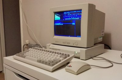

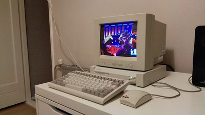

Got a KFC CA6013DS 9 inch VGA monitor from a local auction for just only 10 euro's 😀.
It was kinda dim, so I removed the casing and checked the inside, adjusted the G2 slightly.
It is powered by the Unisys's IEC female port 😀.
Excuse me for the poor evening lighting. It's hard to focus on the monitor's lightsource and balancing the surroundings.

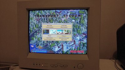

    Transport Tycoon Deluxe (my favourite)

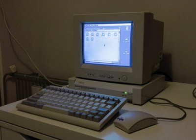

    Running Gem 1.2

    Doom II ;)

What keyboard is that? I believe I saw that exact same model keyboard around 10 years ago at my father's workplace.

That's the BTC 5100C. A cheap rubberdome keyboard.
Ah the keyboard I'm thinking about looks similar but I recall the switches being tactile, as if they had Alps or Cherry MX switches in them.

That's a neat little machine, I have a very similar system also made by Unisys. I think yours uses 72 pin memory if my eyes are working correctly. How much RAM will it take? The only thing that bugs me about mine is it is stuck with 16MB max (which is a lot for DOS but about half what I want for a Win 95 & OS/2 dual boot system).
Reply 17 of 28, by kin
Yes, mine has 2x 8mb edo simm probably the original low profile shaped ones. I don't have anything beyond 8mb laying around, so I can't test it.
