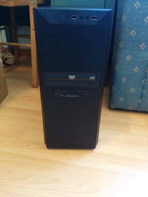

Update:
Well the Mobo & CPU are still to arrive but here's the finished front anyway:
1.54 MiB
911 views
Windows 98 PC - Front View
1.54 MiB
973 views
