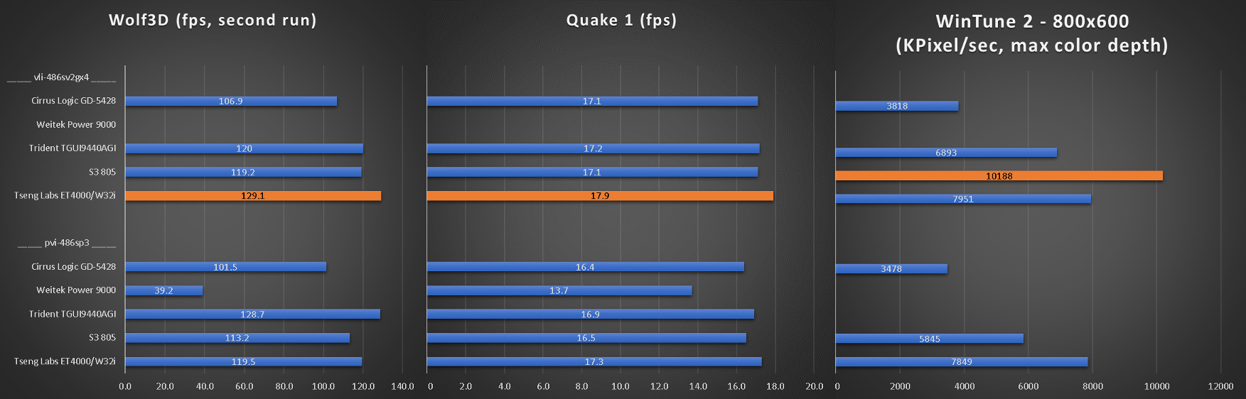

Postby pshipkov » 2019-7-04 @ 05:09
Put your numbers in charts for better readability. Thanks for making the effort. It will be awesome if we see some doom stuff as well.
Btw, what is the mobo you tested on ? Brand, model, chipset, etc.
I will try to test all the isa, vlb and pci cards on my asus pvi-486sp3 mobo and merge your results as well.

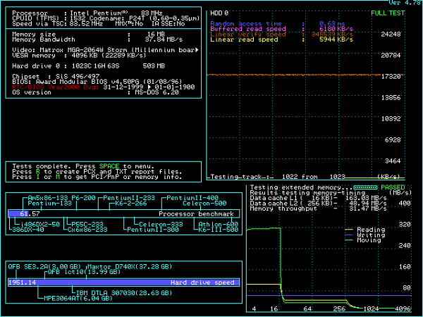

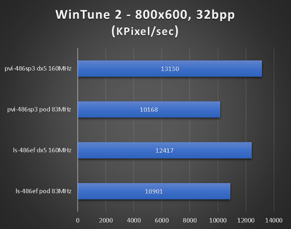

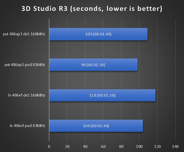

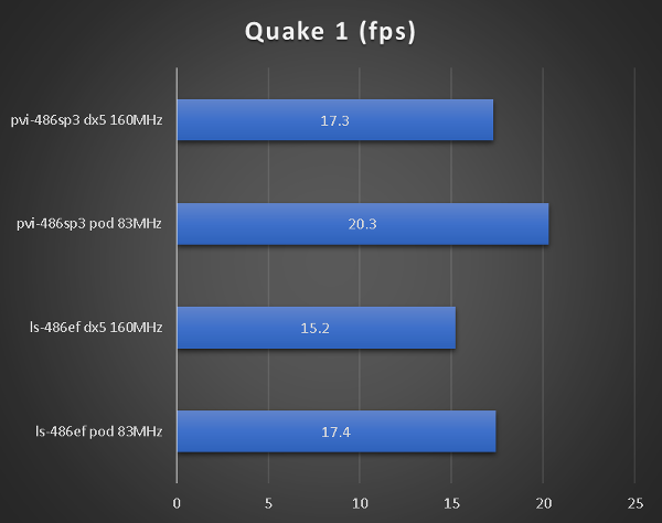

Postby pshipkov » 2019-8-02 @ 01:09

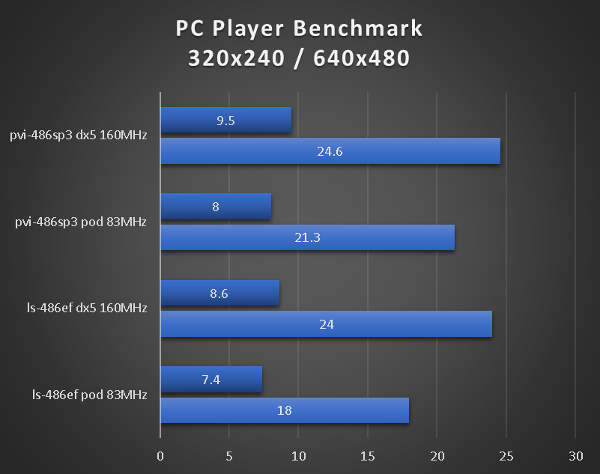

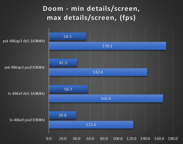

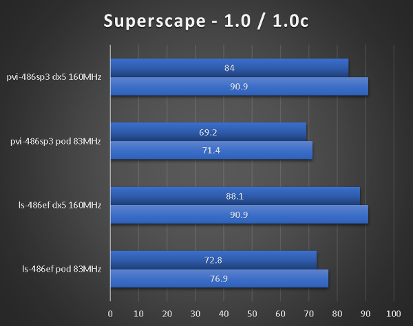

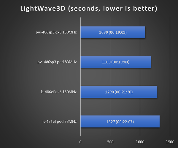

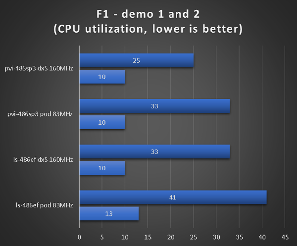

Recently i wanted to verify how two motherboards based on the same chipset compare when one of them is "burdened" with VLB and the other one is not.
So, i picked Asus PVI-486SP3 and LuckyStar-486EF and ran the usual set of tests.
Both of them are from the same period 1995-1996 and rely on SIS 496/497.
Along with that i wanted to see how they handle the highest class 486 CPU at the time (AMD-X5-133ADZ 160MHz) as well as Pentium Overdrive P24T.
Both boards can run the POD at 100MHz. It performed well in the simple DOS tests, but failed at the 3D rendering ones, so i decided to keep it at the default 83MHz. Trying to stick here to my rule of working with completely stable systems.

ASUS PVI-486SP3 with Intel Pentium P24T 83MHz
http://www.petershipkov.com/temp/retro_pc_images/benchmarks/486_mobos/pvi_pod_stats.png
http://www.petershipkov.com/temp/retro_pc_images/benchmarks/486_mobos/pvi_pod_speedsys.png
I used Matrox Millennium MGA-2064W-R3 8Mb, which i consider being the top dog back in 1996.
http://www.petershipkov.com/temp/retro_pc_images/components/486dx5_matrox_1.jpg
score: LuckyStar (1) : Asus (0)
score: LuckyStar (1) : Asus (1)
score: LuckyStar (2) : Asus (1)
score: LuckyStar (2) : Asus (2)
score: LuckyStar (2) : Asus (3)
score: LuckyStar (2) : Asus (4)
score: LuckyStar (2) : Asus (4). This one is a toss.
score: LuckyStar (2) : Asus (5)
score: LuckyStar (2) : Asus (6)
Brief summary:
Final result is 6 to 2 in favor of Asus PVI-486SP3.
I expected the PCI only LuckyStar mobo to perform somewhat better than the PCI/VLB ASUS-PVI one, but apparently PCI and VLB can coexist just fine without any added dead weight.
Quite surprised by the achieved 20+ FPS by PVI+POD in the Quake test.
The synthetic tests gave better CPU scores to the LuckyStar motherboard, but the 3D rendering ones tell very different story.

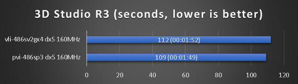

Now lets compare the PCI/VLB/ISA ASUS-PVI board against ASUS VLI-486SV2GX4 rev 2.0 - a VLB/ISA one.
Used the same AMD DX5 CPU clocked at 160MHz.
BIOS settings set to the lowest available timings.
The motherboard supports maximum of 32Mb RAM.
There was no performance difference between 256/512/1024 Kb of cache. Both video graphics and rendering tests agreed on that. So i went with 256Kb of SRAM for the contest.
I noticed that the VLB video cards performance is much more volatile compared to the PCI ones, so instead of picking a single card and running all tests with it, i compared all of them on both mobos. I think this gives a more complete picture.
Clearly one of the best 486 VLB boards out there, but i felt that it had a bit less performance "juice" once i pushed it, compared to the PVI/LuckyStar ones.
The Weitek video card required +1 WS to cope with the system timings.
http://www.petershipkov.com/temp/retro_pc_images/components/vli_486sv2gx4_motherboard.jpg
http://www.petershipkov.com/temp/retro_pc_images/benchmarks/486_mobos/vli_dx5_stats.png
http://www.petershipkov.com/temp/retro_pc_images/benchmarks/486_mobos/vli_dx5_speedsys.png
http://www.petershipkov.com/temp/retro_pc_images/benchmarks/486_mobos/benchmarks_vli_pvi_wolf3d_quake_wintune.png
http://www.petershipkov.com/temp/retro_pc_images/benchmarks/486_mobos/benchmarks_vli_pvi_f1_superscape_pcpbench_doom.png
Image Image
Brief summary:
The main intention of this "study" was to verify if the VLB graphics performance of a CPU and PCI/VLB motherboard is affected negativelly compared to a VLB only one. Looking at the results above - that's clearly not the case.
The PVI board relies on a newer SIS chipset that is better in every way than its predecessor - graphics, offline rendering, IDE speed, etc.
Now i am curious how VLB-less ALI/UMC based motherboards from the same 1995-1996 period stack-up against the tested ones here.
Hope to find some answers soon ...
