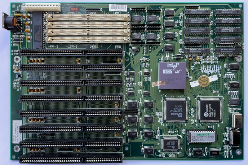

Siemens ROLM 98d5192
Late industrial 386DX motherboard based on UMC's UM82C481AF UM82C482AF UM82C206F chipset.
Unusual beast in truly pristine condition. An evidence that it was used in clean room environment.
72-pin SIMM memory slots.
64Kb of soldered on-board Mosel Vitelic level 2 cache. No option to upgrade (jumpers, hardware path, etc)
External battery only.
No FPU socket.
A "Siemens certified" sticker from May 2001.
More capable boards based on this chipset were examined before, so didn't expect anything special from it and it didn't surprise either.
Supports TI/Cyrix 486DLC, TI 486SXL2 and IBM BL3 processors in addition to the standard 386DX ones.
Not fully stable past 40MHz base frequency, but decently ok at up to 50MHz.
Tested at the peak stability point (40MHz).
All BIOS settings on max except DRAM WAIT STATE = 1 (best is 0).
Didn't bother with full set of tests.
Some of them require FPU which requires a socket which i am not going to bother installing.
Used STB Nitro ISA (Cirrus Logic GD-5434), 2Mb video card.
--- IBM BL3 at 80MHz (2x40), ISA bus at 10MHz
Speedsys:
Wolf3D: 45.5 fps
Superscape: 33.3 fps
PC Player: 7.7 fps (without FPU this test is skewed)
Doom: 18.4 fps
WinTune 2: 2423 kpixels/sec
--- TI 486SXL2 at 40MHz, ISA bus at 10MHz
Wolf3D: 38.0 fps
Superscape: 23.2 fps
PC Player: 6.1 fps (without FPU this test is skewed)
Doom: 12.4 fps
WinTune 2: 1266 kpixels/sec
--- AMD 386DX at 40MHz, ISA bus at 10MHz
Surprisingly the board is unstable in this configuration.
Tried hard to overcome that but without success.
Had to step down to 33MHz for complete stability.
Lost interest right there.

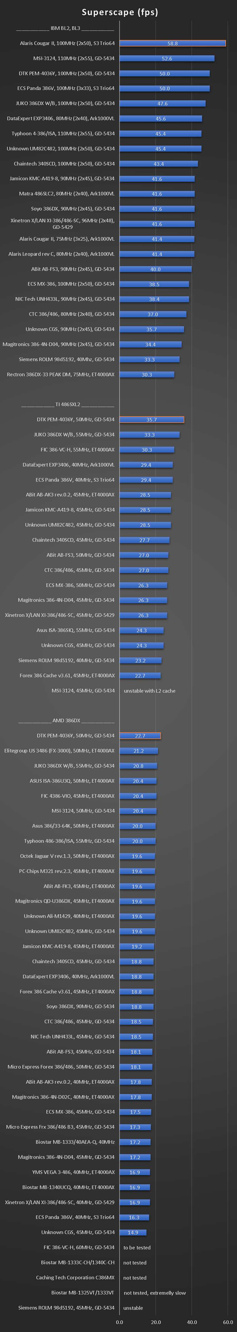

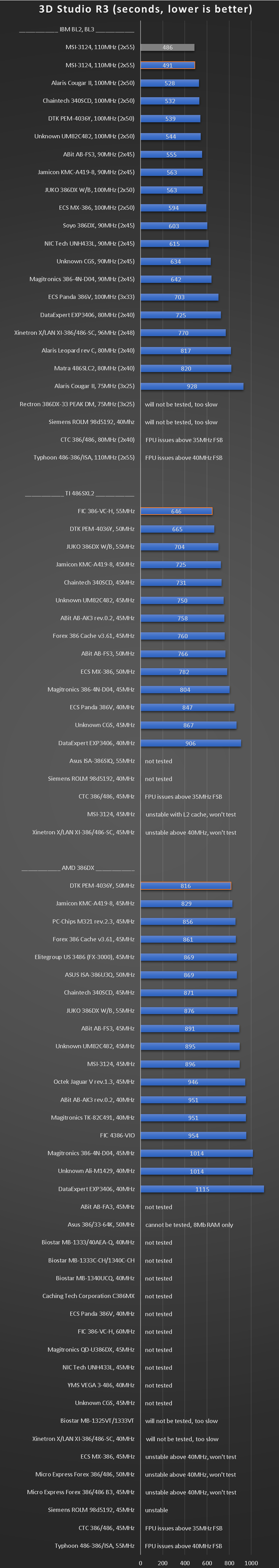

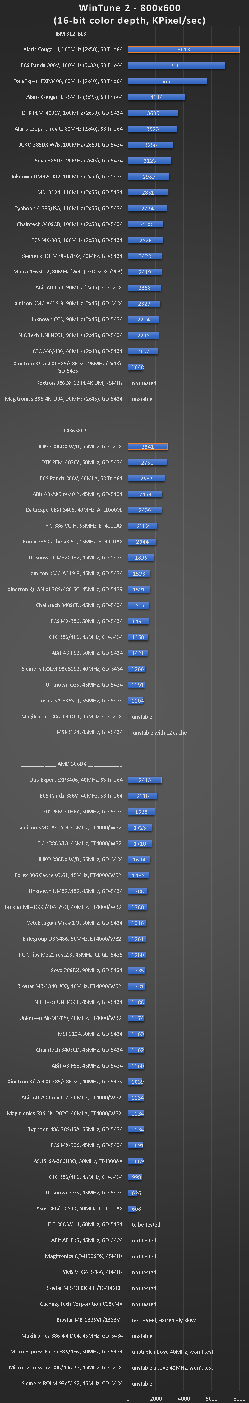

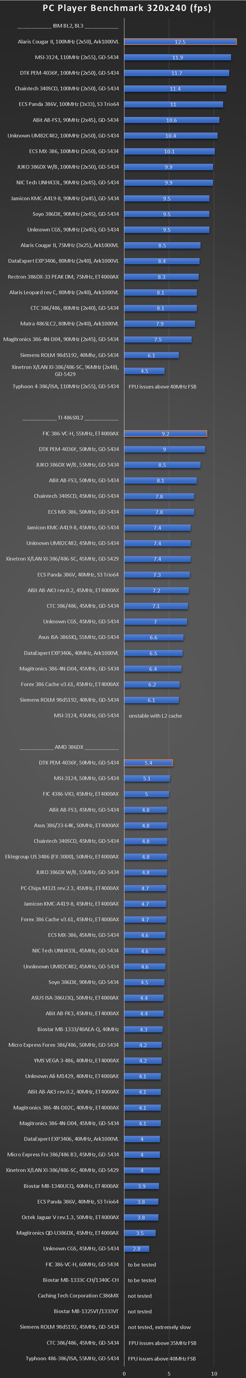

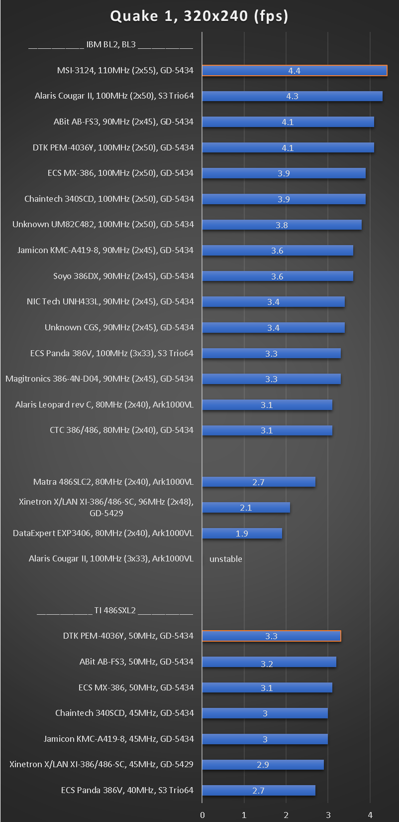

Continuing with the reorganization of this thread by consolidating all collected performance metrics into single chart with references to it from the individual posts.
386 class motherboards with AMD 386DX, TI 486SXL2, IBM BL2/BL3 processors
How to read the data ?
This "study" took place over a time span of several years.
The intention was to identify the best motherboard and built the fastest PC around it.
All tests were carried out from the point of view of peak stable overclock instead of finding the relative clock-to-clock performance on a common basis (CPU/BUS frequencies).
Initially i had only AMD 386DX processors.
Later on managed to obtain SXL2 chips.
Last year switched to BL3 silicon.
At the same time i don't collect hardware, so throughout this CPU progression many of the previously examined boards were not with me anymore.
As a result quite a few boards were not 3-way examined.
The offline graphics tests (3D Studio R3 and LightWave3D) are very sensitive for complete system stability, but also - very time consuming - from tens of minutes to several hours.
Because of that only the most promising motherboards were grinded through them - the ones i considered building that mythical PC around.
So, in a way, these two test (especially the LW3D one and especially the BL3/SXL2 sections) are telling what the best stuff is.
With that said, i am going to fill some of the gaps for completeness.
All items listed as "to be tested" will be updated in the coming days.
Finally, this information covers many (most) prominent brands/models/chipsets from that time.
Gray bars indicate peak performance at compromised system stability.

Woof, massive data compilation. This must have taken some time. Some comments follow.
Not sure if this was an accident, but the Alaris Cougar 3x33 results are missing from the DOOM chart.
It is too bad you did not note the ISA speed. There are those who think running the ISA over 11 MHz is undesirable. From my understanding of your work, is it safe to assume the ISA speed is in the 13 - 20 MHz range, depending on the board and FSB?
To put the numbers into greater perspective, I was thinking it might be good to add results for an i486DX33 or maybe DX2-66.

Took a moment to put everything in one place, but it will be a time saver going forward.
I left few gray bars in the charts as an indication of top performance achieved regardless of complete system stability.
In the case of Alaris Cougar 3x33 for Doom - it is slower than DTK PEM-4036Y with BL3 processor running at 110MHz, so it was not added there.
Only fully stable systems and their results are listed (well, with few small exceptions).
I started adding ISA bus speed to the individual posts.
The left side of the charts (the row description) gets too long if ISA bus frequency is added.
Excel does not allow me to stretch that area further and part of the string gets lost.
But from what i have seen so far - 10 to 14 MHz is working pretty well almost everywhere.
Many boards and expansion cards can handle 15-20MHz just fine.
Added your numbers.
If you can provide the rest of the simple DOS interactive graphics benchmark results at least, that will be great.
They are easy to achieve and quick to test.

@Anonymous Coward
Agreed.
Alaris Leopard is neat, but only the C variant - the one with VLB bus and L2 cache.
Alaris Cougar passes for the premium version, but if you look at the benchmarks - Cougar (3x25) is slower than Leopard in offline compute and FPU heavy tasks, which makes sense.

I've never seen a Leopard rev A or B. I assume they exist...but wouldn't they also be VLB?
I think the board you're thinking of is the Leopard LX (sometimes called Opal LX). That's a different product.
