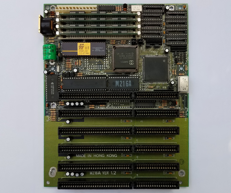

286 from 1990-1992
HARDWARE
  • motherboard: Ilon USA M216A rev 1.2
    cpu: Intersil CS80C286-25 25/30MHz
    • Harris CS80C286-20 20MHz
    fpu: IIT 2C87-12 20/25MHz
    ram: 4Mb 60ns parity FPM
    vga: Tseng Labs ET4000AX 1Mb

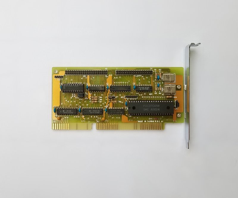

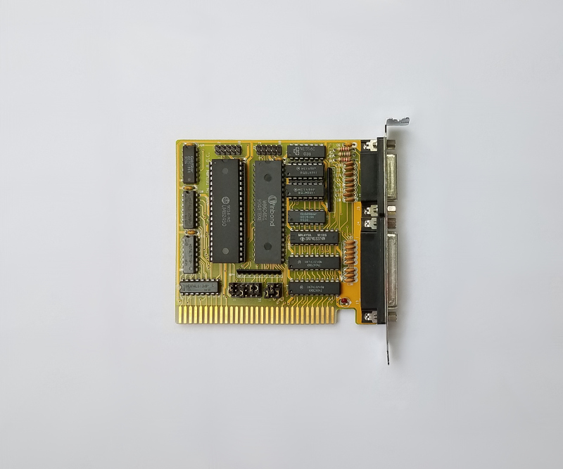

    i/o: AHA-1520A
    • Unknown, FDC37C65B
      Unknown, serial/parallel ports controller
    psu: 450W AT
    input: BTC 5121, MS Mouse
    os: DOS 4.01 + Windows 3.0
    partitions: 1x504Mb
NOTES
The motherboard is actually not that bad - handles IDE and FPU really well, but hates video cards - slows them down to a crawl.
Coretest for SCSI freaks-out when the CPU runs at 25MHz.
The Harris CPU does not overclock at all - anything above the default 20MHz is a no go.

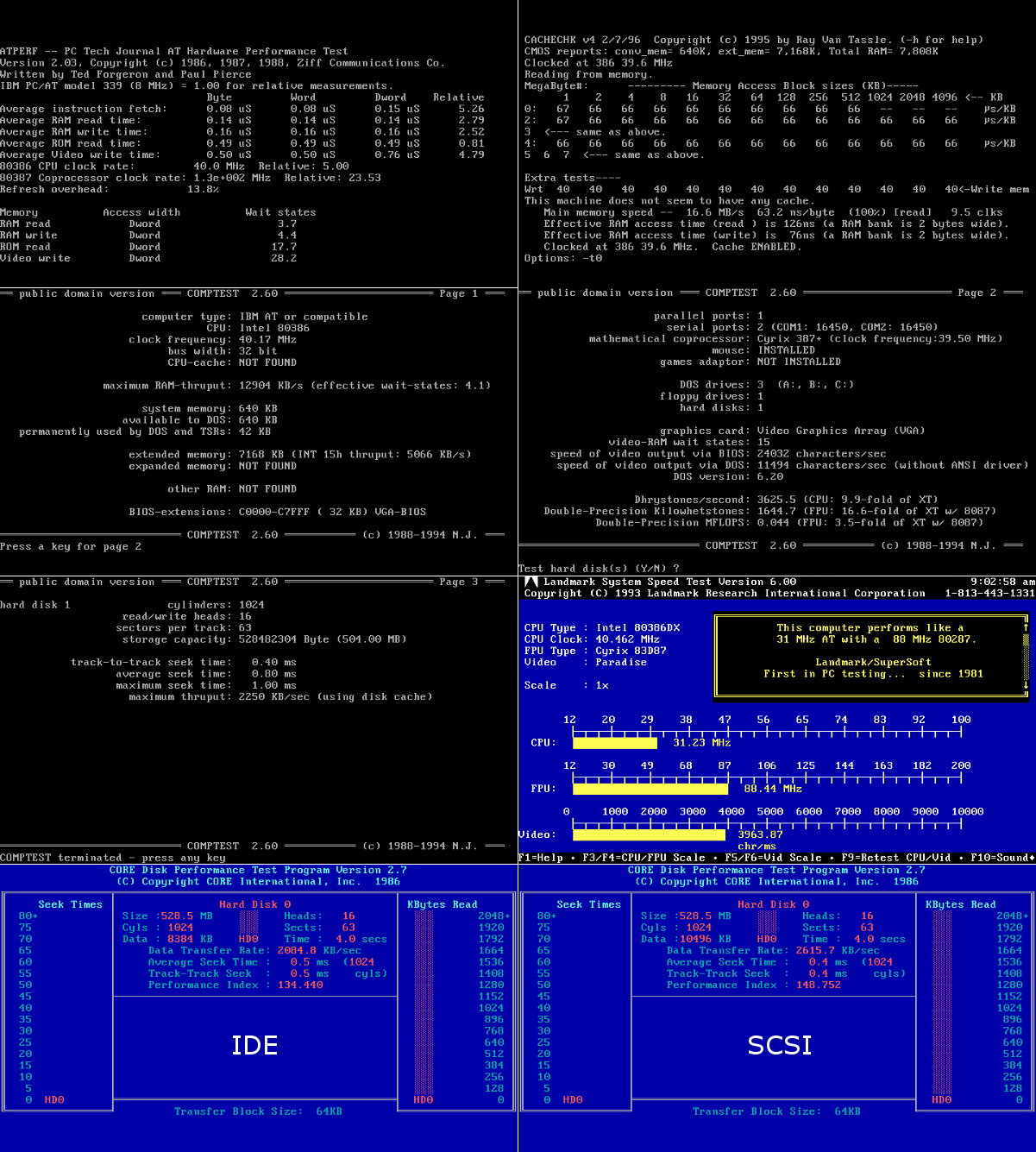

IDE is much faster than the SCSI.
THE CULPRITS
https://petershipkov.com/temp/retro_pc_images … motherboard.jpg (featuring the Harris CPU)

https://petershipkov.com/temp/retro_pc_images … ts/286_2_io.jpg
286 at 25MHz
https://www.petershipkov.com/temp/retro_pc_im … _25_2_stats.png
286 at 30MHz
https://www.petershipkov.com/temp/retro_pc_im … _30_2_stats.jpg

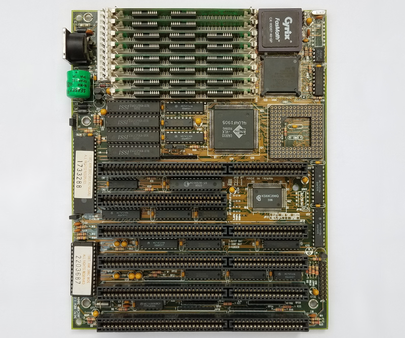

386 from 1993-1994
HARDWARE
  • motherboard: Unichip 367C rev 1.0 WB
    cpu: AMD Am386DX 40MHz
    fpu: Cyrix FasMath CX-83D87-40-GP 40MHz
    ram: 8Mb 70ns parity FPM
    vga: Genoa Systems Windows VGA 24 8500 1Mb (Cirrus Logic GD-5426)
    i/o: AHA-1540B
    • PC Chips F82C712
    psu: 450W AT
    os: DOS 6.2 + Windows 3.11
    partitions: 1x504Mb

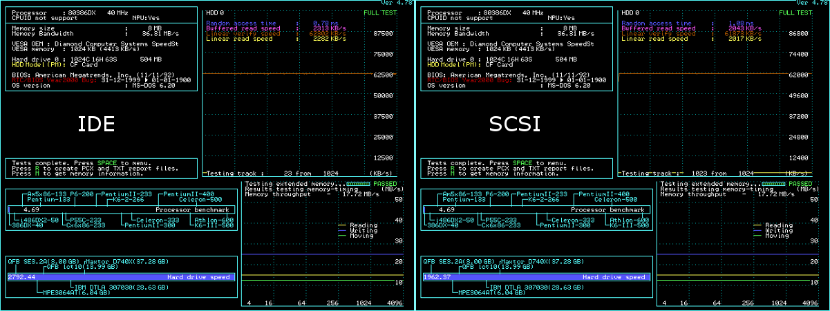

NOTES
This motherboard is a top underperformer.
Initially i thought it may be unoptimized BIOS, but trying 30 other BIOS-es strongly indicated that the problem is the hardware itself. From past experience - if the hardware is ok, some BIOSes can improve its performance at least partially. Not this time around. There is a real log jam somewhere in that mobo.
SpeedSys memory metrics indicate no cache, which is strange. Tried different sets of chips to eliminate the chance of faulty ones - no bueno. This seems to be the main issue of the board.
THE CULPRITS

https://www.petershipkov.com/temp/retro_pc_im … _40_2_stats.png
https://www.petershipkov.com/temp/retro_pc_im … _2_speedsys.png

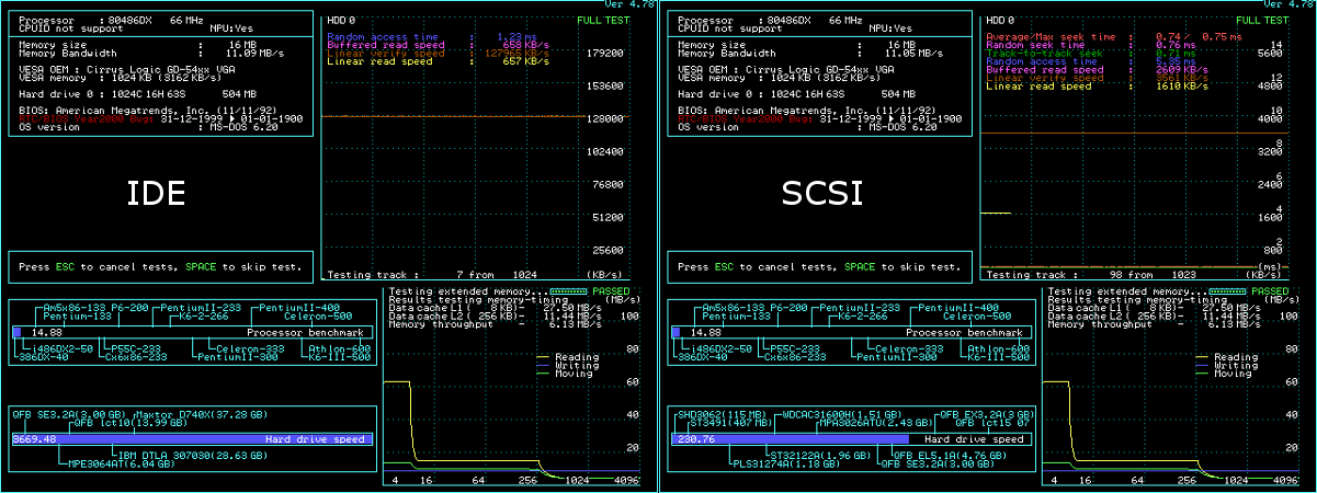

NOTES
Another impressive underperformer.
Kind of strange, because exactly the same chipset is used successfully by Asus and other manufacturers in very fast motherboards.
Visual inspection and comparison with such motherboards confirms that the hardware components match. So it must be the BIOS then.
Tried over 40 different BIOS-es. Started with ones from other SIS 461 based boards, but at the end the one that finally "clicked" was an UMC BIOS. Unexpected i admit, but the mobo woke up. VGA and IDE performance was where i expected them to be. The only trouble was an apparent disagreement between the BIOS and the memory controller about the amount of installed RAM. So, they settled on 1MB only.
The system does not boot at 40MHz FSB.
Cannot find manual for the CL combo board. Its default IDE performance is the same as the GoldStar Prime 2.
Also, there are memory expansion slots - any idea what chips should go there ?

https://www.petershipkov.com/temp/retro_pc_im … 86dx2_stats.png
https://www.petershipkov.com/temp/retro_pc_im … x2_speedsys.png

D'aww! I <3 motherboards that are just big enough for their ISA slots. 😄

Yeah, the compact mobos are cool in their own way.

In case my questions got lost in the long post above:
- i cannot find any info about the Cirrus Logic combo jumper settings. Any hints ?
- what memory should go into its available slots ?
Any idea why the 386 mobo seems to be cache-less ?
It is not BIOS settings, or faulty chips for sure.

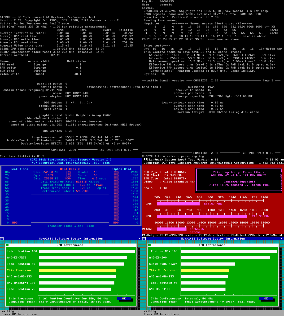

LuckyStar-486EF with Intel Pentium P24T 83MHz
http://www.petershipkov.com/temp/retro_pc_ima … s_pod_stats.png
http://www.petershipkov.com/temp/retro_pc_ima … od_speedsys.png

ASUS PVI-486SP3 with Intel Pentium P24T 83MHz
http://www.petershipkov.com/temp/retro_pc_ima … i_pod_stats.png

Quite surprised by the achieved 20+ FPS by PVI+POD in the Quake test.

Now lets compare the PCI/VLB/ISA ASUS-PVI board against ASUS VLI-486SV2GX4 rev 2.0 - a VLB/ISA one. As usual, i am capping hardware at year 1996.
Used the same AMD DX5 CPU clocked at 160MHz. BIOS timings set to the lowest available values (for best performance).
Used modified BIOS from Evolution of a Socket3 System to a POD @100MHz. It enables the motherboard to function well with L2 cache in WB mode.
Initially i didn't notice performance difference between 256/512/1024 Kb of cache, but closer inspection proved me wrong, so i maxed out the cache to 1024Kb for the contest.
Performance of VLB video cards is much more volatile compared to PCI ones from that period, so instead of picking a single card and running all the tests with it, i compared couple of them on both mobos for more complete picture.
The Weitek video card required +1 WS to cope with the system timings.

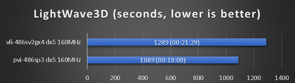

Brief summary:
ASUS VLI-486SV2GX4 is clearly one of the best "clean" VLB motherboards out there - stable, fast, compatible.
The two systems are more or less equal at handling DOS/Windows graphics, with slight advantage for VLI.
PVI shows advantage in the 3D rendering department.

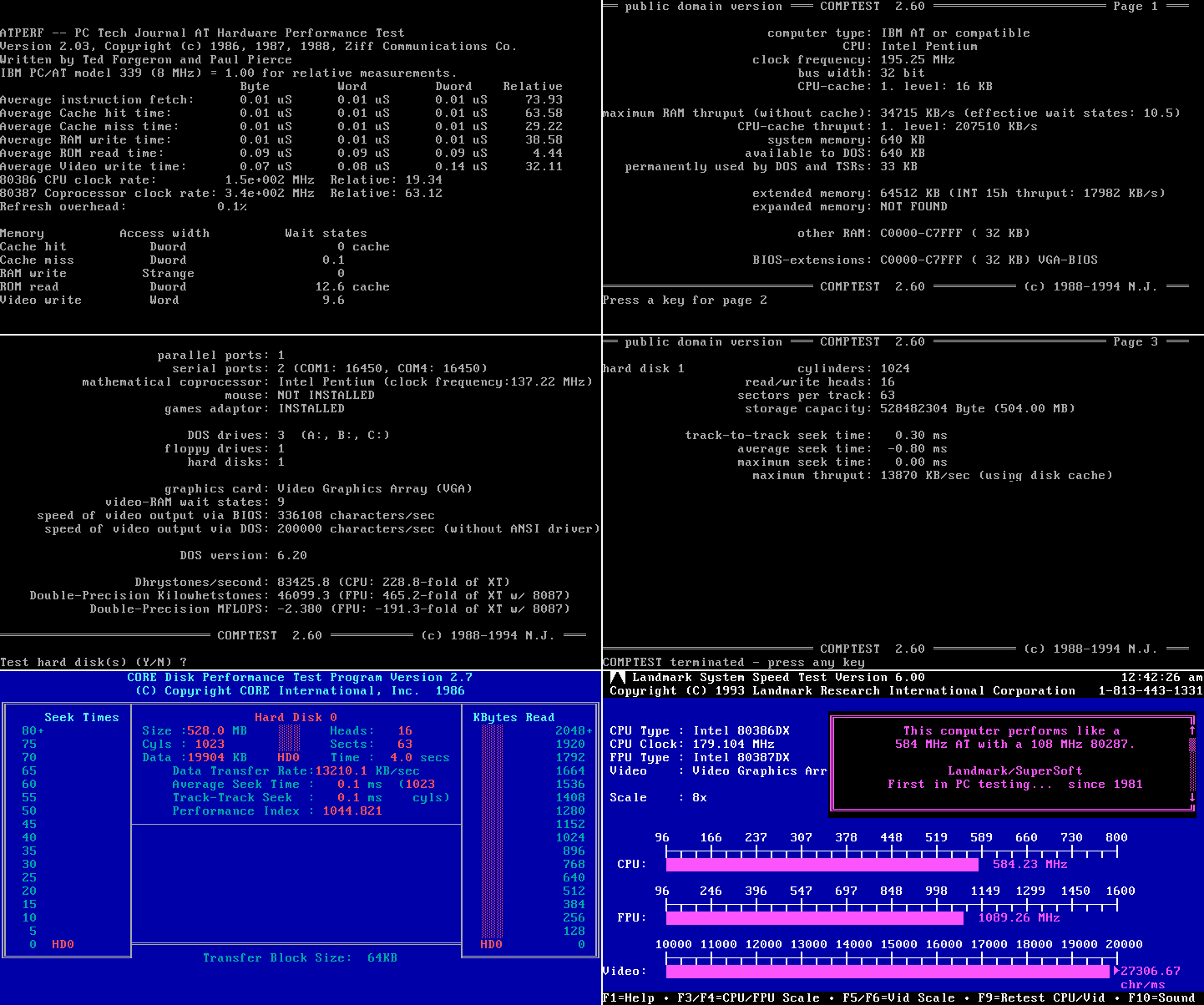

Decided to share some findings about quite interesting motherboard - the ASUS 386/33-64k.
The hardcoded 64Kb of DIP22 SRAM, max 8Mb of RAM and barebone BIOS (no timings, etc.) hint at an early stage 386 hardware, offering somewhat subpar performance.
UPDATE: After stumbling upon some random information online, i just realized that this motherboard is what Asus started their business with back in 1989 - the one they developed "blindly" without having access to an Intel's 386 CPU prototype. Or, at least that's what the legend says.
I was annoyed by the lack of options in the BIOS, so tried bunch of other ones that are rich on cache/ram timings.
Results were not great - performance was same or worse, compared to the default BIOS.
Okay, fine. Lets see if it overclocks then.
I didn't expect much, given the already low entry point, but for my surprise this boy turned out to be unexpectedly capable in that department.
It works completelly reliably in DOS and Windows 3.1 at 50MHz. Well, with one exception - it failed all 3D rendering tests. None of the 3DCC apps can get to UI, let alone render something - a big red-flag in my books.
There was a bit of complication with finding the right video card for the 50MHz FSB. After combing through bunch of them, it was an ET4000AX from 1998 that did the job. The rest were unstable, or didn't light up at all.
I started with 60ns RAM, but noticed that 70ns is fine too.
Ok, what about 55MHz ?
The motherboard takes it with ease (along with the CPU and VGA), but the IDE controller gives up.
Tried bunch of other IDE/SCSI adapters - they all hang during their turn at the end of POST.
Too bad ...
Screen does not light-up at 60MHz.
http://www.petershipkov.com/temp/retro_pc_ima … motherboard.jpg
http://www.petershipkov.com/temp/retro_pc_ima … _2_et4000ax.jpg
For some reason i was not able to capture screenshots of NSSI.

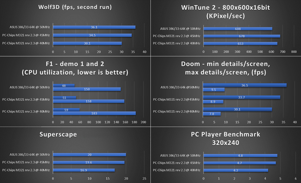

Quick comparison with one of the fastest 386 motherboards i know of - the PC-Chips M321.
As you can see, the system ticking with 50MHz is enough to overcome its inherent slowness and position itself ahead of M321 in most tests.
Even the ASUS motherboard lags in DOOM full screen + high detail and WinTune2, the DOOM test is not really relevant for a 386 system, so it kind of does not matter and the Windows GUI performance while slower than the M321 is still within the performance ballpark.
Conclusion:
Despite the relativelly low base performance of this motherboard, it transforms itself into one of the fastest boards i have seen to date, when running at 50MHz.
The 8MB RAM limit won't be a problem for games, but will be for memory demanding productivity applications and for Windows 3.x.
While the failures with 3D rendering hint at a problem in there, i think a great 386 gaming system can be built around it.
