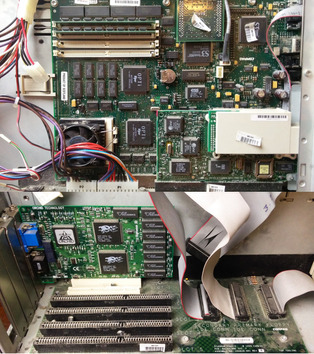

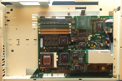

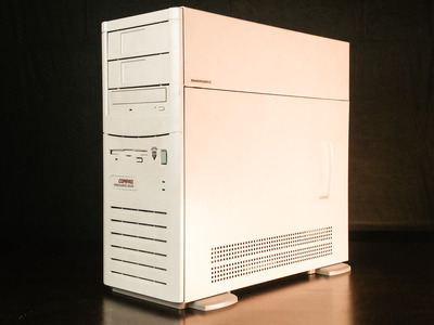

This is my friends old Compaq and I´m going to refurbish it for him. However, I could use a little guidance from people wiser than myself 😀
First, this is what I have to work with: The case is very, very dirty but otherwise it´s in excellent condition, no yellowing or bad scratches, so the outside parts will only receive a thorough cleaning. I will disassemble this computer completely and I´m going to paint the bare frame in almost similar beige as the case, it´s a little bit darker than the original beige because the store I visited didn´t have the perfect match but that´s fine. And yes, I will do it right with a proper primer and matt lack finish, it will NOT flake off! The hard drive is missing, but that´s fine because I would´ve replace it with an IDE2SD adapter anyway. I will also throw a SB Live! CT4830 in there mainly because I have an extra one.
Upgrades my friend made in the 90s:
- 200 MHz Pentium CPU
- Orchid Righteous 3D
- two 16 Mb SIMM sticks.

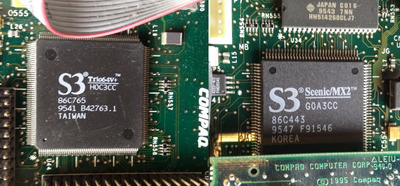

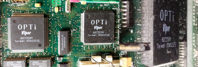

This computer originally had Windows 3.11 but we agreed that Windows 95 OSR 2.5 would be a better option. There´s something that I´m a bit worried though, and what I could use a little help with: I don´t what kind of driver solution would be best for the integrated on-board chipsets, nor can I even find any. Here´s what we can see from the pictures:
-Opti Viper 82C556M, 82C557M and 82C558M
1.55 MiB
1549 views

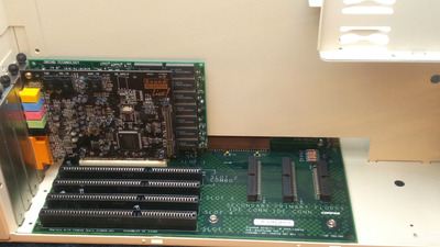

- graphics chipset S3 Trio64V+ H0C3CC and S3 Scenic/MX2 GOA3CC
1.33 MiB
1549 views

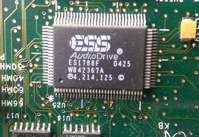

- and sound chipset ESS Audio Drive ES1788F
627.35 KiB
1549 views

Reply 2 of 37, by PC Hoarder Patrol
Nice looking system 😀
The support files for these old Compaqs are normally remarkably easy to track down as all the SoftPaqs are still available online, both thru the HP ftp site and from the many independant mirrors of the same...e.g. this SoftPaq for the Trio64V+ is SP1879 (there may be newer ones as well) and supports Windows 95 on the Presario 9500 series. Here's a link to the readme file
ftp://ftp3.hp.com/pub/softpaq/sp1501-2000/sp1879.txt

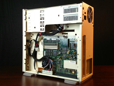

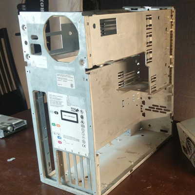

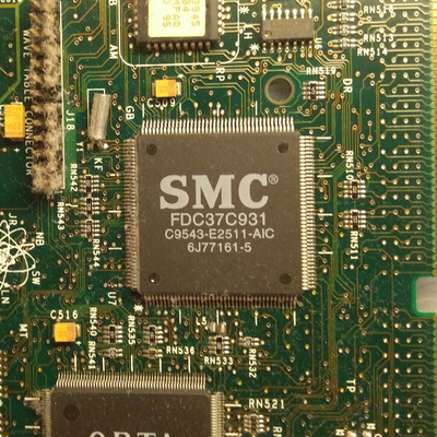

Small update:
There was another chip hiding behind the modem
813.76 KiB
1471 views

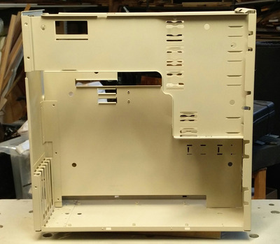

Here´s the stripped frame
731.93 KiB
1471 views
And here it´s recovering from spray poisoning
366.99 KiB
1471 views
698.34 KiB
1471 views

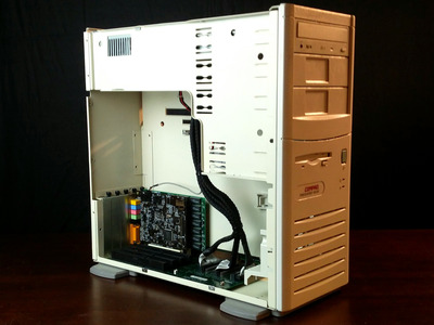

Here´s a couple of new pictures:
1014 KiB
1315 views
1.23 MiB
1315 views

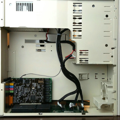

I thought that by now this project would be finished with a video but a few parts are still on the way. So, here´s a little photo of my cabling solution.
600.15 KiB
1276 views

Looks 95% the same as my Presario 9232. The one in your pictures appears to have the extra 1MB graphics RAM for the onboard Trio64 as well. There's a wavetable header on the motherboard you can use for MIDI in DOS with the ESS sound which is quite good. I put a Dreamblaster S2 in mine. Also, you can find the Compaq Presario 9548 Quick Restore CD on Archive.org which may work on the 9538. I ended up finding the quick restore CD's for my 9232 on eBay.. I believe it also covers the 9500 series, but you need to input your serial number which would normally be on the rear of the case just below the PSU fan exhaust.

I love your cable job! looks great! I hope mine comes out that nice.

Reply 19 of 37, by Surrat
On the baseboard, just inside of the floppy cable socket, check that component Q2 isnt damaged, or has its legs touching.
When you removed that heavy black tape, it hit that part and bent it over, can see it in the picture.
