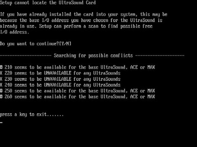

Hi
I'm having trouble with the pre-installed files for ultrasnd. I keep getting an image stating, "cannot locate ultrasound card" and "searching for possible conflicts" with a listy of I/O adresses (seen in the .jpg).
file.php?mode=view&id=85180
Does anyone have a solution cause the same issue happened when I tried to install the original GUS 410 file.
    43.02 KiB
    3393 views
Reply 125 of 146, by Neville
I imagine you have already set up sbtype=none and gus=true in your DOSBOX.CONF file. Gravis UltraSound emilation is disabled by default, I imagine in order not to cause conflicts with the SB emulation.

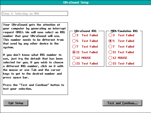

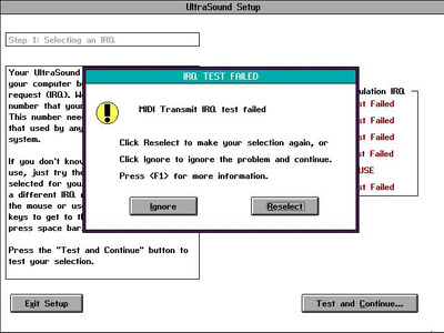

Reply 127 of 146, by MADJACK2171
Yes , that helped, thankyou . However now I have run into a new problem. When I try to set up the irq I am greeted with this message.
file.php?mode=view&id=85249
On dos config the gus emulation irq is set to 5. By default the set up screen goes to this.
file.php?mode=view&id=85250
I don't exactly know how to fix this issue or what to do.
