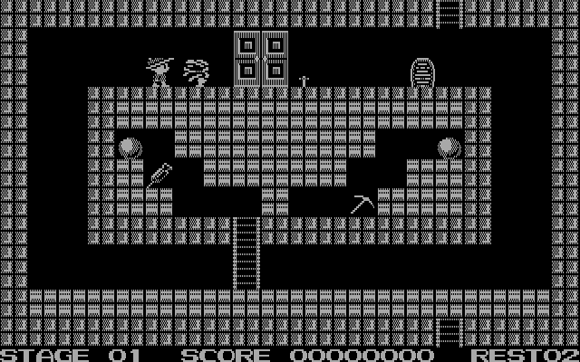

    King's Valley Level 1 snapshot
Reply 14 of 15, by wiebermensch
If you run King's Valley under VGA, it enters into MODE 04H(i.e, 320*200 4-color graphics).
But if you run King's Valley under Hercules(or edit DOSBox.conf to machine=cga and play the game on DOSBox), it enters into MODE 06H(i.e, 640*200 2-color graphics) and you can play the game without a jerky screen.
