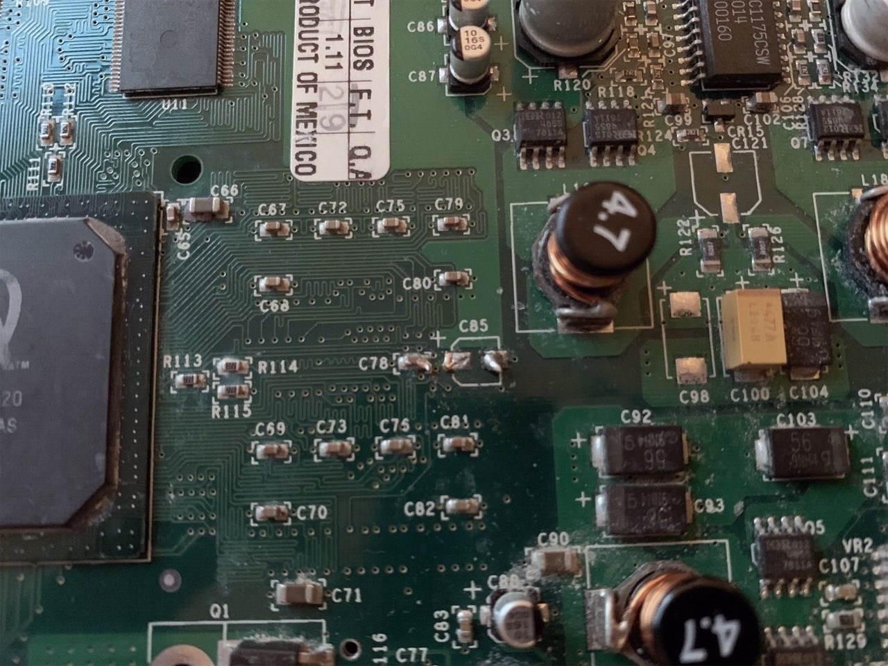

I have a voodoo 5 5500 AGP which has been in a P3 800 system for many, many years now without any issues at all. I reached that point where i was simply playing games instead of chasing hardware....
Until I stumbled on an old industrial PC with a P3 1000EB going for free. My ASUS cusl2-c board can handle this beast with a Bios update so I decided to upgrade 😀
All is good, everything works but i noticed in testing that one of the Aavid fans on the Voodoo 5 consistently stops running after a couple of minutes!
My first thought was one of panic and many many hours of searching for hardware replacements - like the 'good old' days of this retro computing rabbit hole. I find that there are many compatible heat-sink and fan combos that I can buy (assuming that I risk the freeze, credit card and screwdriver procedure). However I find that when I remove the fans from the card, the rear heat-sink has far less dust suggesting that this fan failure has not been a recent phenomenon.
view?usp=sharing
Did I just get lucky, or can I just run the card with the heat sinks and good airflow within the case?
What are your experiences?

in my experience the fans are absolutely needed as the VSA chips do get hot
they probably don't get hot enough so they die but they are old chips and heat is never good for them - so a good airflow will prolong their life
in other words: put some fans back there 😁

do u really want to chance it burning up when these cards sell for as much as they do.
i would say either get a new original fan or replace the fans with a nice noctua fan of the same size.

These chips need a lot of cooling. If your case airflow is good, you can contemplate passive cooling, but that would require a much larger heatsink than the default ones. If you don't want to mess around with different heatsinks, get two new fans. Second the recommendation for Noctua - they're neither the cheapest nor prettiest, but they are both quiet and reliable. I use their 80mm and 120mm fans for replacing old fans in PSUs, and I even prefer 120mm Noctua Redux fans for my Zalman CNPS6000 passive CPU heatsink.

The cooling solution for retail cards was such, that you could insert that thing in a desktop case with hardly any airflow and it would get by on merely the static, 40°C+ air inside that and its convection/heat radiation on the case shell. Anything else might cause a RMA case with a roughly 100 % cost overhead to the revenue. Noise, meanwhile, was not considered any issue.

Heh.. the V5-5500 I bought new from CompUSA got the original heatsinks taken off pretty quickly and I mounted large socket 7 heatsinks on there.
For airflow, I made a bracket to hold either one or two 80mm fans above the card to blow air down towards the motherboard.
With a setup like that, the card will not even get warm.
You do definitely need good enough airflow to cool the card no matter what heatsinks you have. The stock ones are too small IMHO.

Valuable card, and getting even harder to find. Invest in some decent fans. It is well worth it.

Found two copper coolers (heavy) and some decent 5v fans for mine, not too different to stock, but much better cooling capacity than the cheap aluminium coolers.

Mine are SUNON 5v 40mm fans (Part number: KD0504PFB2-8). Luckily for you these are standard 3-pin fan headers, I had to replace the plugs with smaller ones for my Voodoo 5.
