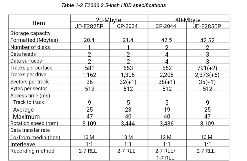

I googled that apparently Toshiba T2000 has this same drive (JD-E2850P) as option and technical data was listed on its manual:

Well, this is solved and I guess I learned something. Asus A7V133-C and that noname Pentium MMX 166 laptop (normally running Win 98) were too new to correctly use this drive, but Compaq LTe 5100 had no problems formatting this correctly and booting from it.
