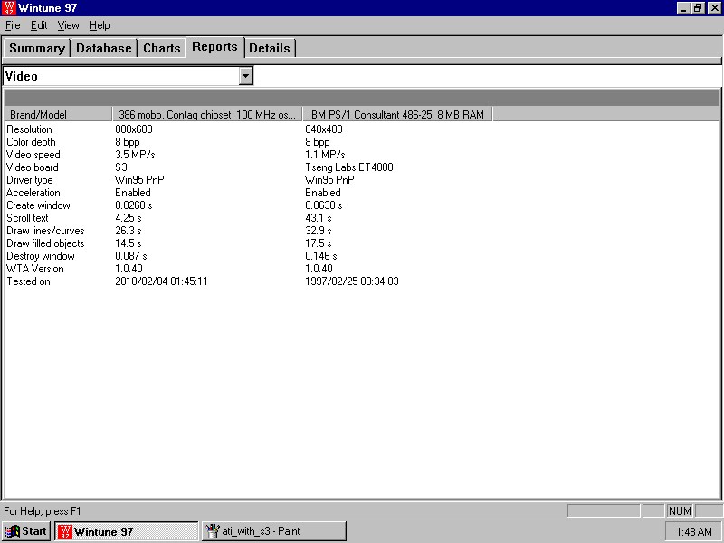

Here is the Display Adapters section. I simply updated the Diamond Speedstar device driver, and told Windows 95 to use the 8514 driver instead. And that worked!
Also, I am able to use 1024x768 resolution at the desktop, in 256 colors. Perhaps that's nothing special? Anyway, with the resolution set to 1024x768, I ran Wintune 97, and I get these video results -
The video speed seems to be about 4 times faster than a Tseng ET 4000. For my testing, I used a 100 MHz osci, and set the bus jumper to /6. That means the bus speed is 100/6 = 16.6 MHz.

Correction. I'm sorry, but in my message above, I said that the bus speed was set to /6, which is 100/6=16.3. This is not true. Instead, it was set to 7.2 MHz. There are a couple of jumpers to set the bus speed, and I hadn't reset all of them. After I saw my mistake, I set to bus speed to /6, but the BIOS POST displayed garbage, and I could not boot up Windows 95. The reason is because my VGA card, a Diamond Speedstar x24, cannot tolerate this high bus speed. I tried /8, and that worked OK. The bus speed is now 100/8= 12.5 MHz. I reran WinTune 97, and I get this video result -
Strangely, the video speed has dropped. Also, I am running the resolution at 640x480. However, all of the other tests seem quicker.

I tried a new VGA card, alongside the ATI 8514. I tried a Diamond Stealth 24. It's got an S3 chip on it. This card doesn't like high bus speeds. I could only set the mobo's bus speed jumper to /10 setting, which is 100/10 = 10 MHz. Here is Wintune 97's video results for this card -
I then told Windows 95 to use the ATI 8514. I reran Wintune 97. I get a slightly better video speed, and the draw filled objects seem to have improved.

I ran the ATI + Cirrus Logic VGA card at various bus speeds, and Wintune 97 showed no speed improvements, at higher bus speeds. Also, the ATI could not tolerate the bus speed set to maximum, which is 100/4 = 25 MHz.
