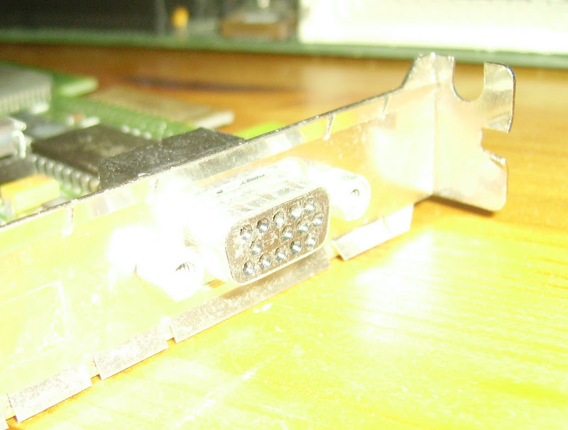

Also, the HP "video board" as the seller describes it won't allow me to attach a VGA cable to it. On this HP card, one of the pins on the VGA socket is "filled in", so I can't attach my video cable to it. Damn. I didn't know about that!

Could you give a schematic of which pin is filled in? Compare it to a pinout of standard VGA so you know which pin is missing. Perhaps that pin isn't even needed?

If I look at the vga connector on the other card, it's pin number 9 which is filled in. You can see where pin number 9 is here.

Could you get us a picture of the VGA socket with that one "blocked" pin?
If I remember correctly not all pins are used on the HD DB 15 socket. At least one of my older CRT monitors has 1 or 2 pins missing at the connector.
If it's an unused pin, I'm sure you could build an adapter so you could physically connect your monitor.
EDIT: just read your reply. Appears pin9 is a line supplying or recieving 5volts (might be used for monitor detection on some gfx cards?) If your desperate, I'd just pull it out of the cable (if you have a spare that is) ... as that is the pin missing on the connector of my CRT monitor (which has worked fine the past 15 years).

I edited my post above at the same time you were posting. Pin 9 was the key pin, so it's "OK" there's not a hole there. But I confess it's the first time I see one card with it actually missing.

Thanks a lot for the additional advice, people. I'm definitely going to get this special card to work. I'm sure I've got something with a VESA header on it, somewhere! BTW, I took a pic of the other HP card, using macro mode on my crappy camera.
