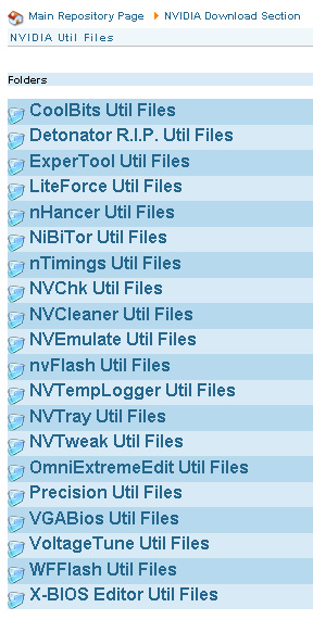

I notice on the mvktech.net site, there are a lot of sub folders for nVidia. Here they are below. Are any of these utils worth checking out? Thanks a lot for any advice.

I've just looked at the version number of RivaTuner that I use - it's 2.24! 😀 I've started invesigating all of that software, mentioned above.
Coolbits - registry hack which allows overclocking. Ver 1 for detonator driver, ver 2 for later versions.
Detonator RIP - fully uninstalls detonator driver
ExperTools - primary purpose: overclocking
LiteForce - bit like RivaTuner
nHancer - N/A: not for w9x, I think
Nibitor - N/A: begins with FX 5 series
That's as far as I've got so far. I'll plough through all of them, and report back...
