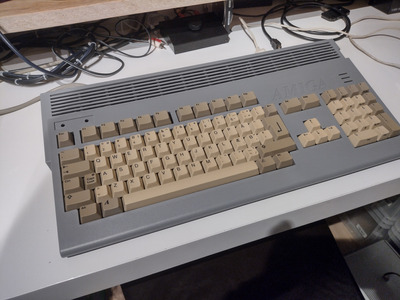

Swapped the case on my Amiga1200 with the new one. And realised that I need to find a better case-badge/label for this machine. It has a serial number and sticker on the back, so it is just the one on the top-left of the keyboard that I need to find. There are a number of nice metal badges on eBay from a Polish seller that I might look into.
Right now the machine is recapped. It has kickstart 3.1 and a Tsunami-1230 accelerator (64mb Ram). There is an IndivisionAGA-MK3 installed that gives HDMI output and I have one of them 90 degree angled CF/IDE adaptor with an extra 40-pin IDE port installed as well. HDD storage is a 16gb Sandisk Ultra card, that I have installed Zeb's HDD-Image on. The keyboard membrane is also changed for a brand new one. As it was recapped with solid state caps (the ones without electrolytic fluid), then I have an Amiga1200 for the next many many years to come. I had it recapped at a person in Copenhagen, and it was a bit more expensive than the person from Finland, however I did get my machine back faster.
Now I am only missing the new keycaps and that case badge. I have asked the makers of this case, when they will make them avaliable in shops, and they answered that it will happen once all kickstarter supporters have recieved their set's. So I am guessing it will happen late 2022 or early 2023.

Somehow changed the vibe from Amiga to Atari

Actually yes. Now you mention it, it kind of looks like Falcon and 1200 had a child.

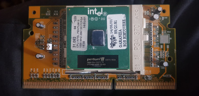

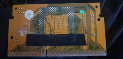

Modded an ABSOLUTELY NO-NAME slotket I got for free. Would only run Mendocino-based Celerons and nothing else.
15 minutes, a wire and lots of patience later, I am running a 1GHz P3 Coppermine (1000/256/133) on my BE6-II with no issues.
Here's some photos. I applied some tape on the back to insulate an wire that I had to solder for Coppermines to work.

Absolutely gorgeous.

How do you modify these slotkets for coppermine? I didn't know that was a thing.
The capacitors in the right are also looking pretty bad.
Remove pin AM2 (one of the corners), bridge AH4 and X4.
http://krick.3feetunder.com/370mod/
Also this mentions another wire connected for SMP though I didn't exactly understand.
Simple passive slotket on 694X dual cpu board for Coppermine/Tualatin?
As for the caps, they're on my to do list right now. I have a dead FX5200 and a dead USB card to pull some fresh Rubycons for the slotket.
