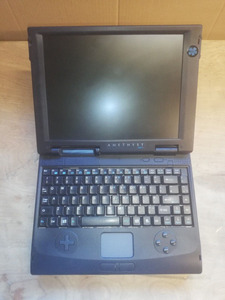

I'm packing things to go into storage since I'm going to be moving quite soon and I have enough time to finish up this project at least, a few months back I bought this Kapok 5400PT laptop - the flower means it's got a TFT and it's got a gamepad on the palm rest???
163.53 KiB
980 views
The four buttons are actually buttons 1 and 2, with the extra 1&2 buttons having a little circuit added so they're turbo 1&2.
Of course, the hinge plastics are disintegrating so today I made a 3d print to reinforce that area then epoxied it on. Had to grind loads away because I put plastic in the area that the hinges rotate into when opening the screen and they don't want to glue down but it'd holding.
It has this strange little port on the side that looks like it'd be for a floppy drive since it's a 26-pin thin connector that clips in like you'd see on external floppy drives, but this one has it built in already. Nope, that port is for the gameport dongle of course, it does have a little bat in a diamond shape that looks sorta like a joystick printed by it.

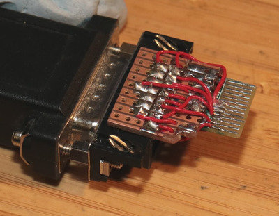

I traced this out to how they connect into the ESS sound chip and derived a pinout:
9.7 KiB
No downloads
edit: I should add, pin 1 is on the edge facing towards the keyboard, not the front of the machine.
Using a scrap 0.8mm PCB segment from a dock adapter PCB I made - with 1.27mm spacing between each pad, I was able to wire up a gameport and it works just as well as it was designed - which is not very well 😀
117.1 KiB
980 views

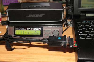

For some reason they only wired up one set of the x & y axis and only 2 buttons. It also likes conflicting with the built-in gamepad and switching between joystick and gamepad seems to often require a reboot.
But midi out works and that's great!

what an interesting project and great way to make the incompatible compatible! i enjoy reading about these kinds of things

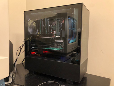

I got a NuXT Turbo XT last year and I had been looking for a case for it. The other week I came across this Thermaltake S100 Micro ATX Case that I thought would be a nice fit so I ended up ordering it. It's a bit bigger (fatter) than I expected it would be but I think the White edition looks pretty "cool". I currently have a Seasonic PSU in there, not sure if I'm going to swap it out with something else. The Seasonic doesn't really fit the case, style wise, and might be a little bit to beefy and I could probably use it elsewhere at some point.
The NuXT and the Blasterboard make a good combo. Very happy with both of them.

Awesome look! XT computing isn't my bag, but putting old (looking) thing in new case certainly is - I like it!

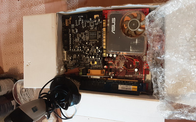

Today I put a card sideways because I thought it would be goofy, and it was, and it amused me.

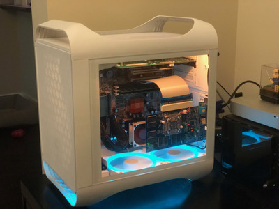

how do you even get a OS or files on it? there are no 5.25 or 3.5 bays on that case

On USB or FireWire ... doooh... it's 2k dual , not 80286 , I managed to load files on my 486 with extracting hdd from it so anything is posible.

i like that look you've selected for this build, 'modern' with 'retro' - can see all that goodness on display
