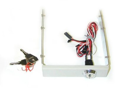

If you have two IDE hard drives on the same channel, you could install Windows on one drive and DOS on the other, then buy/build and install something like this:
60.22 KiB
627 views
It's a switch that connects to the jumpers on the drives and allows you to select which drive is master, thereby choosing which drive will boot. I did this on my first custom build to dual-boot Windows 2000 with Slackware Linux, and it worked quite well. It has the advantages of not requiring any software bootloaders or changes to the boot priority in the BIOS, and if necessary one of the drives could be reformatted or even physically removed without affecting the other drive whatsoever. I'll admit, this was something I missed from the upgrade to SATA on a later custom build.
There was a commercial version of this switch called the NickLock (which is what the picture shows), but they currently seem to be made of unobtainium. They're quite easy to build though, I made mine out of some keyboard lock switches salvaged from a couple old AT cases and just mounted them in the panel on an empty drive bay. If you do make your own, I recommend turnkey switches and not toggle switches, because toggle switches are too easy to accidentally bump. Although I've never actually tried changing master/slave settings while a computer was running, I imagine accidentally doing so would result in Very Bad Things™.
