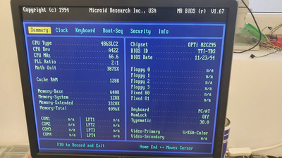

I spent hours going through my library of MR-BIOS images and yet, I think the best candidate was out there at least since November 2022. Let me know if it works. I am still waiting for my board to be delivered.
Reply 19 of 45, by sonicx
Everything works fine
