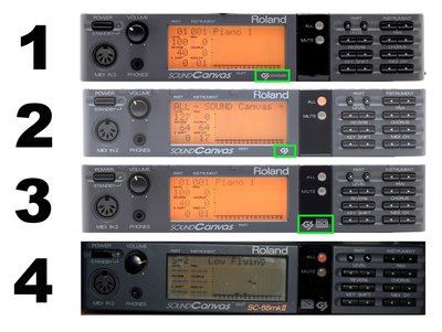

Hello.
What the differense of SC-55 revisions for DOS gaming? https://i.imgur.com/S2Yw1pb.jpg
v1 GS Standart
v2 GS
v3 GS GM
They all are different or 100% identical except design of front panel?
Or v3 GS GM = v4 SC-55 mkii ? (design is similar)

Reply 1 of 17, by derSammler
Afaik, "GS" was first one (own that), then came "GS Standard", then GS/GM. However, the front panel doesn't really tell about the firmware version, which is what is actually more important. Early versions do not do GM reset correctly (GS reset is done instead) and have one patch placed differently.

Reply 3 of 17, by firage
The non-GM SC-55's peculiarities were the de facto standard for a little while. There's at least a dozen games that use the first generation's capital tone fallback behavior. I don't think interpreting GM resets as GS resets has too many unintended consequences when playing GM music; conversely, Blood, Duke Nukem 3D, Dune II, Might and Magic IV & V do expect to use GS features after a GM reset. The Fl. Key Click vs. Breath Noise swap can be annoying - the first gen arrangement is going to be incorrect most of the time for that.

Reply 4 of 17, by infiniteclouds
For DOS gaming the most compatible without any tweaking are the GS (non-Standard) modules with serial #s starting with BD, CD or DD. These units are 1.20 or 1.21 firmware which have capital tone fallback as well as Breathe Noise.

Reply 6 of 17, by infiniteclouds
Yeah -- the 1st generation is the 'GS Standard"
Reply 8 of 17, by Firstrun70
Thank you for answers.
Differences:
"GS standart" - #121 Fl. Key Click, no Breath Noise tone, cannot initialize GM mode via the front panel, has capital tone fallback
"GS" Control ROM 1.10 - #121 Fl. Key Click, no Breath Noise tone, cannot initialize GM mode via the front panel, has capital tone fallback
"GS" Control ROM 1.20 1.21 2.00 - #121 Breath Noise, Fl. Key Click as a variation tone, cannot initialize GM mode via the front panel, has capital tone fallback
"GS/GM" - #121 Breath Noise, Fl. Key Click as a variation tone, cannot initialize GM mode via the front panel, has capital tone fallback
"mkii" - #121 Breath Noise, Fl. Key Click as a variation tone, can initialize GM mode via the front panel, no capital tone fallback
1. These differences are right?
2. Are any other differences exists?
3. How to test: "Fl. Key Click", "Breath Noise", "reset GS", "reset GM", "Rx GS Reset", "capital tone fallback" ?
4. Are any hardware differences? (yes) Or only Control ROM version? (no) Anybody dumped Control ROM*.bin? Anybody uploaded another Control ROM by yourself? If I will take "GS/GM" version and will upload Control ROM 1.00 into him, then will it become "GS standart"?

Hi!
I have a question that might be dumb. I got a SC-55 just as the number 2 in the first's post picture, without the GM logo.
How can I be sure that I am running this unit in GM mode? The manual for the mkII (page 36) says that to initialize GM, I need to turn the unit ON while holding PART > and when "Init GM, Sure?" is displayed I need to press ALL. But for some reason this message won't appear on my unit, it is like it is not programmed like that. I checked the buttons (they work fine) and how to activate the GM and MT-32 modes and those seem to initialize OK.
I wonder if it is because my model does not have the GM logo on the front (non mkII) that this initialization mode is lacking? Maybe it came with later revisions? (mine is firmware 1.21) Do I need to do something in particular to activate GM on my unit or if it would start automatically and configure itself for GM once I run a game like, let's say, Leisure Suit Larry 6 from DOS. This particular game seems to sound better in GS mode than the normal one when I just turn on my unit in default mode.
I just don't want to run games that use GM and do it wrong with this particular unit. Specially the ones that seem to have soundtracks that were composed with the SC-55 (and mkII) itself.
Thank you, I really appreciate your help.
UPDATE: I think I found my answer in another post: Roland SC 55 first batch able to play GM games properly?, so it seems my unit can not do GM right? I need to get the one that says mkII on the front. Thanks again.
Reply 14 of 17, by Joseph_Joestar
holaplaneta wrote on 2021-08-28, 02:48:
You might want to take a look at this thread: Apparently not all GS-only sc-55s are the same, some are GM
From what I gather, a SC-55 with the GS logo, a serial number greater than AC94800 and firmware 1.21 is one of the best versions. If that's what you have, then you probably don't need to worry about compatibility issues.
